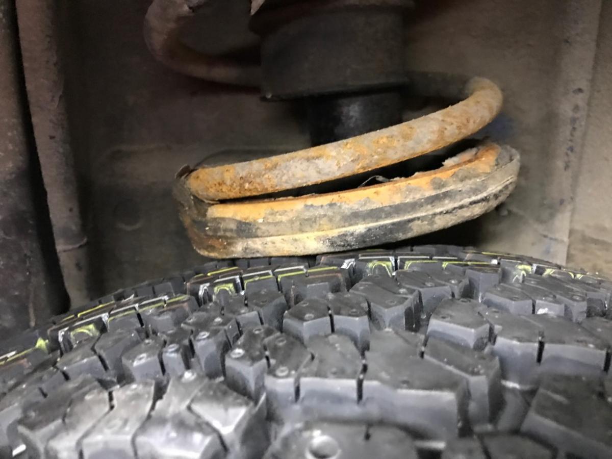

So, Im having a clearance issue on the rear.  I have an 03 impreza wrx
lifted with forester struts and springs.  I got my Grabber 215/65R16
AT2's mounted on my stock wrx  rims.  The problem in the rear is the top
of the wheel is hitting the lower spring/strut perch.  Not sure whats
going on.  Could I maybe have the two rear struts switched around?  Not
sure if that would make a difference.  I would post a pic on here, but
not sure how.
not sure how.
I'm not surprised they are rubbing, I have 205's on mine and 15's and I BARELY have any room.  I can't even fit a finger in there.  You may need different offset wheels.  Hopefully someone else has another solution, but I just barely scraped by on my clearances.
