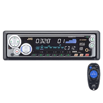

The head unit isnt even a newer one. Its about 4 or 5 years old. I dont know if it would make any difference, but the head unit is actually a JVC, not an Alpine, but when we first got the car, it had an Alpine that was supposedly a few months old, and it stopped working not long after we got the car, so i just stuck a cheap JVC i had from another subaru in it. I enclosed a pic of it, so you can see what it looks like. As you can see from the pic, no usb, no dvd, no navigation, just a basic am/fm cd player.
