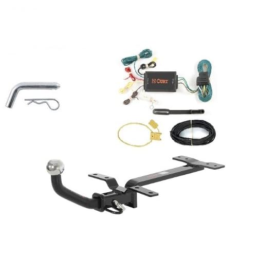

So yeah, I am definitely not gonna pull this camper. I will, however, pull a utility trailer.
I went ahead and bought a Curt hitch, model 112751-59146, off of Amazon for $185.12. Looks like four bolts in the trunk of the wagon, and two u-bolts in the bumper, so that shouldn't be too hard. Comes with a Euro style 1 7/8" ball, which would be the best thing to keep me from towing this camper, as it requires a 2" ball. So if ever get tempted, I have to buy a ball mount and a 2" ball. Also comes with the wiring to hook it up with separate brake/turn signals.

Unless you need it to fold for storage, take off those silly posts with casters behind the wheels. They like to get caught when you go into and out of driveways.
And if you don't need it to fold, I recommend welding the 2 halfs, so it doesn't flex so much.

After I wrote my previous post, I got excited and installed the hitch last night. Installation was a lot simpler than I thought! The u-bolts in the bumper were 20x easier than I had anticipated, and drilling into the smuggler's compartment was just as easy. Wiring was pretty straight-forward too.
Posted Image
Posted Image
I did a test drive last night, and found I had some electrical problems.
1) The euro ball moves around slightly inside the receiver, and when it does, the lights turn off on the trailer. Have to unplug the 4-pin connector and plug it back in to get lights again.
2) If I have the brakes and one turn signal on at the same time, the headlight/taillights will stop working (although the brake lights and turn signals still work).
This morning, I have fixed it though.
1) With the ball mount moving around, I fixed that by running another ground wire from the trailer to my car. It's easily removable, so I can take it off when I disconnect the trailer.
2) I improved the power connection and the ground connection on the taillight converter in my car. It seems to have fixed my brake/turn signal dilemma.
