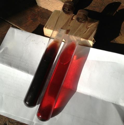

Fluid from donor trans doesn't look all that good

It's pretty dark
#2
Posted 23 January 2013 - 01:59 PM
How does it smell and what, if any, kind of crud is in the pan?
#3
Posted 23 January 2013 - 02:41 PM
Pan's not off yet, smells the same as fresh but less strong, so at least it doesn't smell burnt...
#4
Posted 23 January 2013 - 02:54 PM
Could be it had just never been changed? Burnt smell is usually a bad sign

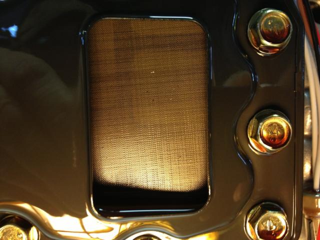

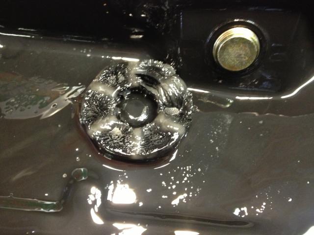

#5
Posted 23 January 2013 - 03:46 PM
Inside looks more promising.
I scraped the goop on the magnet to one spot on it, and the pan has no goop in the bottom of it.

#6
Posted 23 January 2013 - 04:27 PM
If you're not smelling a burn smell and you're not finding crud in the pan I'm thinking you're okay. I've seen that color come out of smooth transmissions before. Probably just old.

#8
Posted 23 January 2013 - 06:14 PM
+1 on grossgary's comments.
I have removed fluid that looked like mud and had the most incredible smell, and still the trannies functioned Ok after proper flush.
