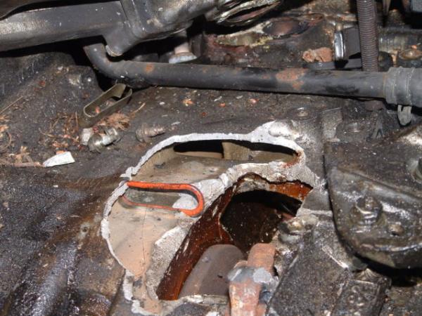

As far as throwing a rod, the sound and the hole in the top of the block would make that easy to diagnose.  The whole would likely break through the top-of-block coolant transfer channel, causing a massive coolant leak.  It is also likely to break loose the mounting of the power steering pump.

This is a typical picture of a thrown rod in an EA82:
So, does the top of your engine (underneath the intake manifold) look something like this?

No, it appears to be all intact.
