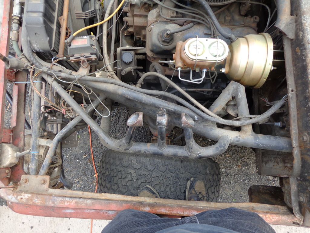

Uberoo Posted July 14, 2015 Author Share Posted July 14, 2015 So after more or less all day of measuring stuff,sketching stuff into autocad. I think I have come up with a front crossmember with revised suspension mounts that after I convert to a twin A arm suspension and coil over it should theoretically have 11.5" of front wheel travel with 8.25 of up travel and 2.75" of down travel.I could have better down travel if I wanted to run control arms that were flat at ride height,but I like some ground clearance. Clearancing the body enough for 31" tires to travel up that far ,however, might be a bit of a kicker.For now though the plan is to lay the foundation for long travel, and get it rolling with the stock struts while I collect the coilovers and other bits for long travel.On the plus side, the revised suspension geometry should make it so that the ea81 axles live a long life at the 1.5-2" of suspension lift it will end up running. Quote Link to comment Share on other sites More sharing options...

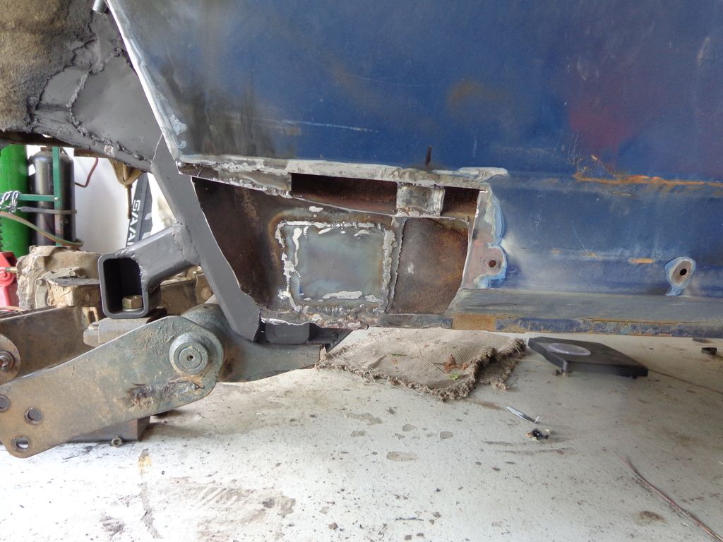

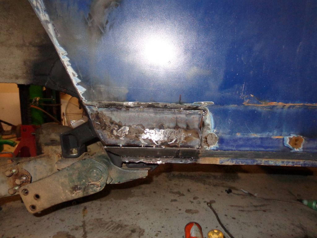

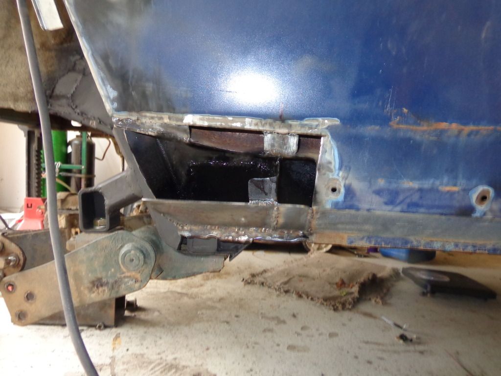

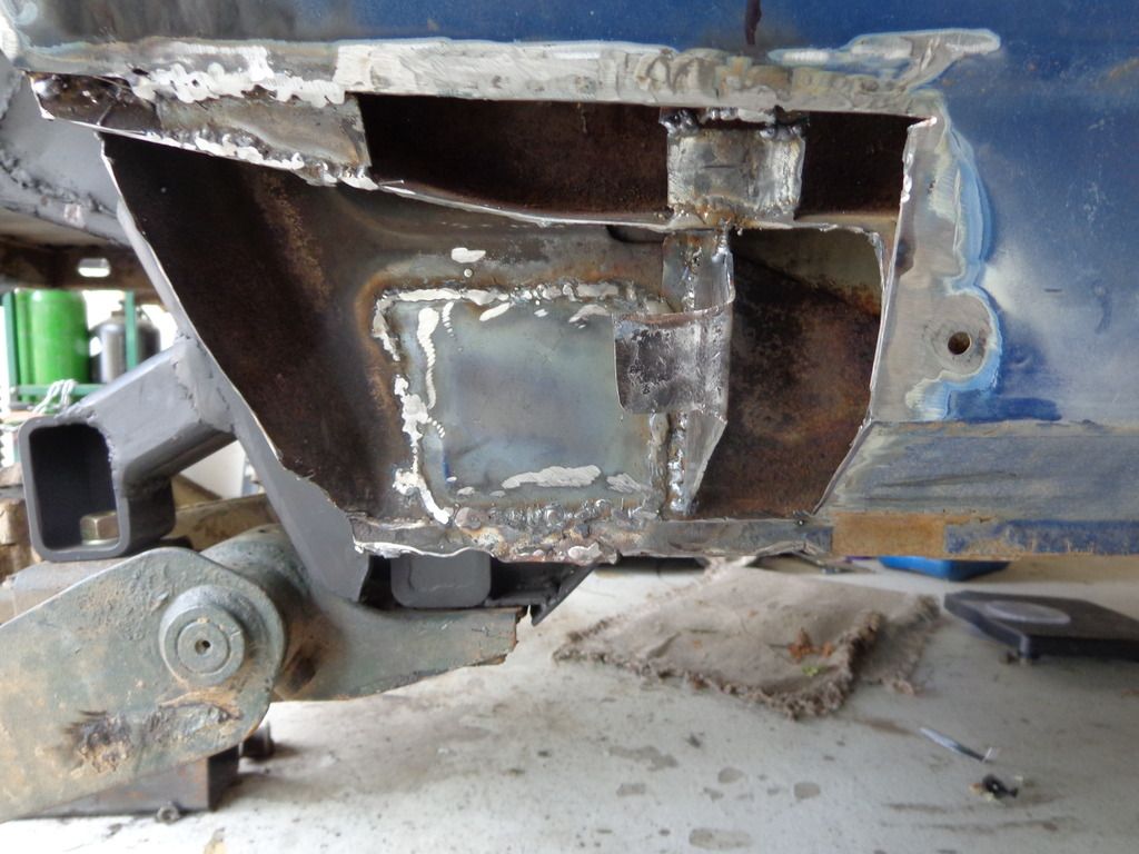

Uberoo Posted August 17, 2015 Author Share Posted August 17, 2015 So due to the fires/smoke and 100*F+ days I haven't been able to get much done.The garage is needed to park a car next to the brat so I have been working on the rust repair on the right rear corner. I cut out all the rust and welded in a patch panel Then I remade the inner brace Then I made the lower edge of the sill. I made some pieces to connect one of the inner layers with the outer skin but I neglected to take pics of them.I did weld on the outer skin,somewhat, anyway. The ground down area in the center of the plate is where I cut a slit and welded it to the inner layer.Then I ran out of shielding gas. I have a little bit of flux core I could use,but other than that I'm broke and with no money coming in progress is essentially stopped. Quote Link to comment Share on other sites More sharing options...

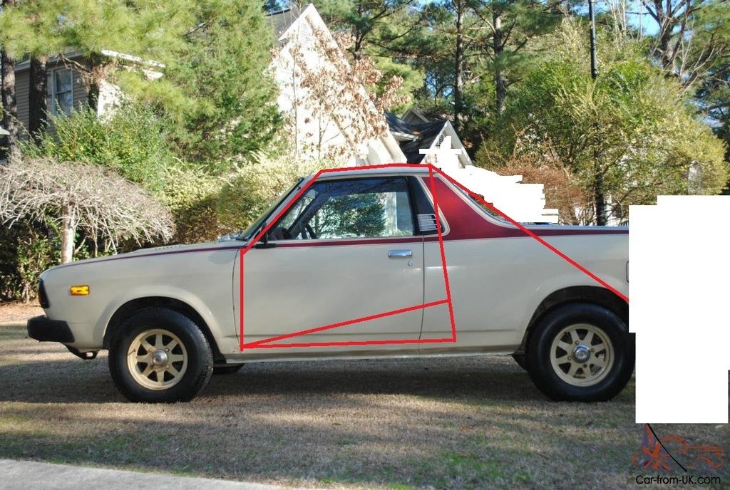

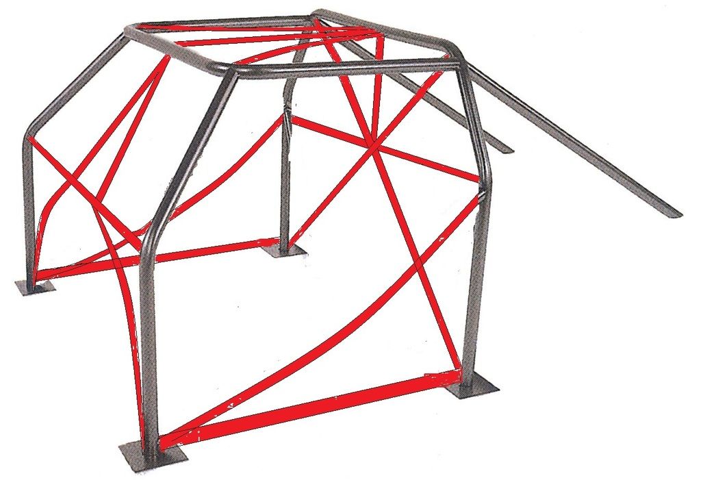

Uberoo Posted August 31, 2015 Author Share Posted August 31, 2015 So this is what I had in mind.I modified this rollcage image with red tubes to show what I was thinking. my paint skillz suck so bear with me. I'm thinking 1.5 x.095 might be a touch small so with extra tubes it should make up for it. Quote Link to comment Share on other sites More sharing options...

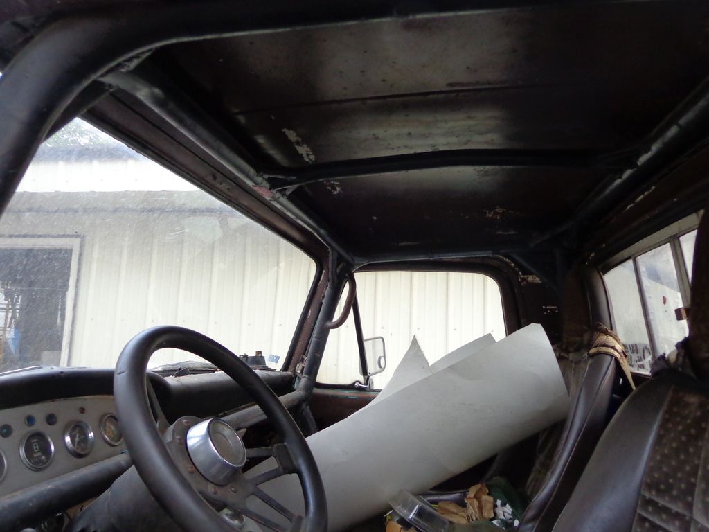

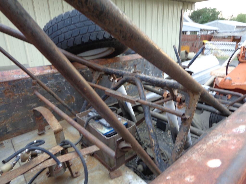

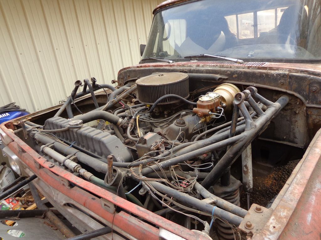

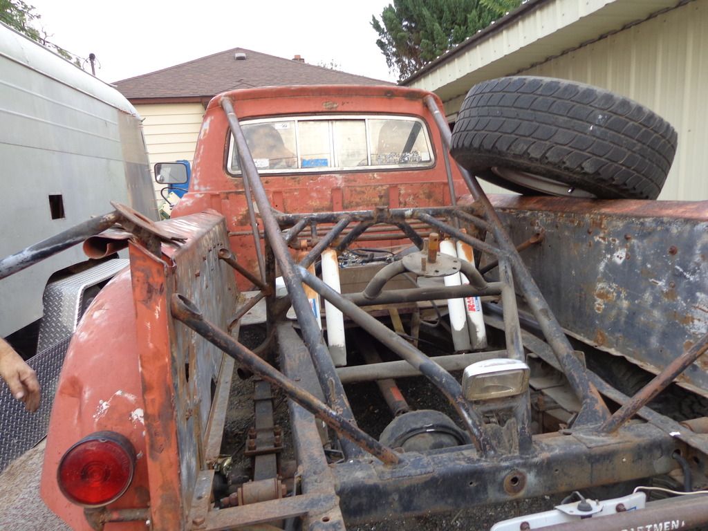

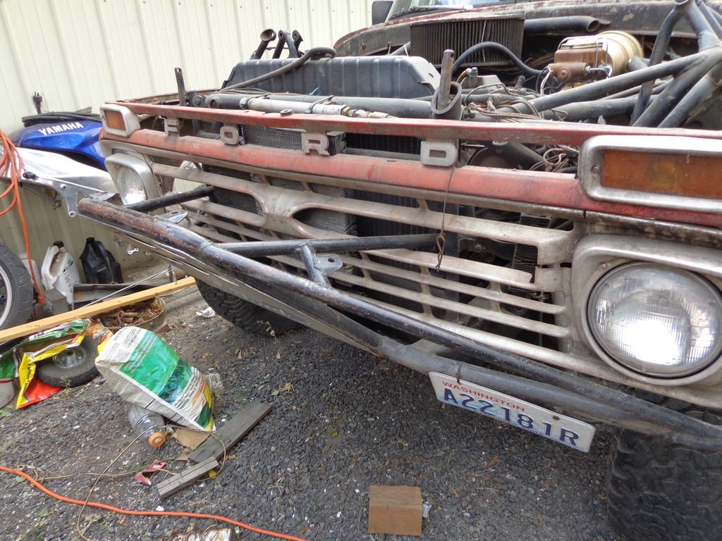

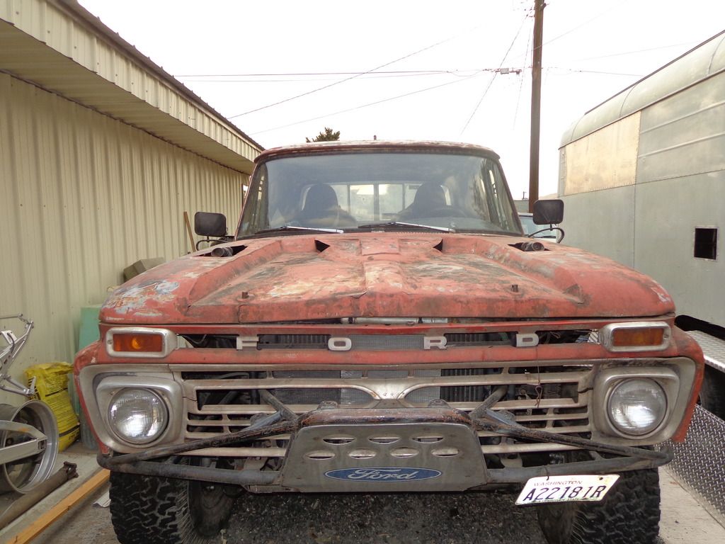

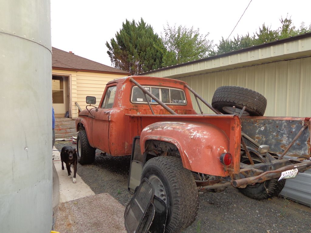

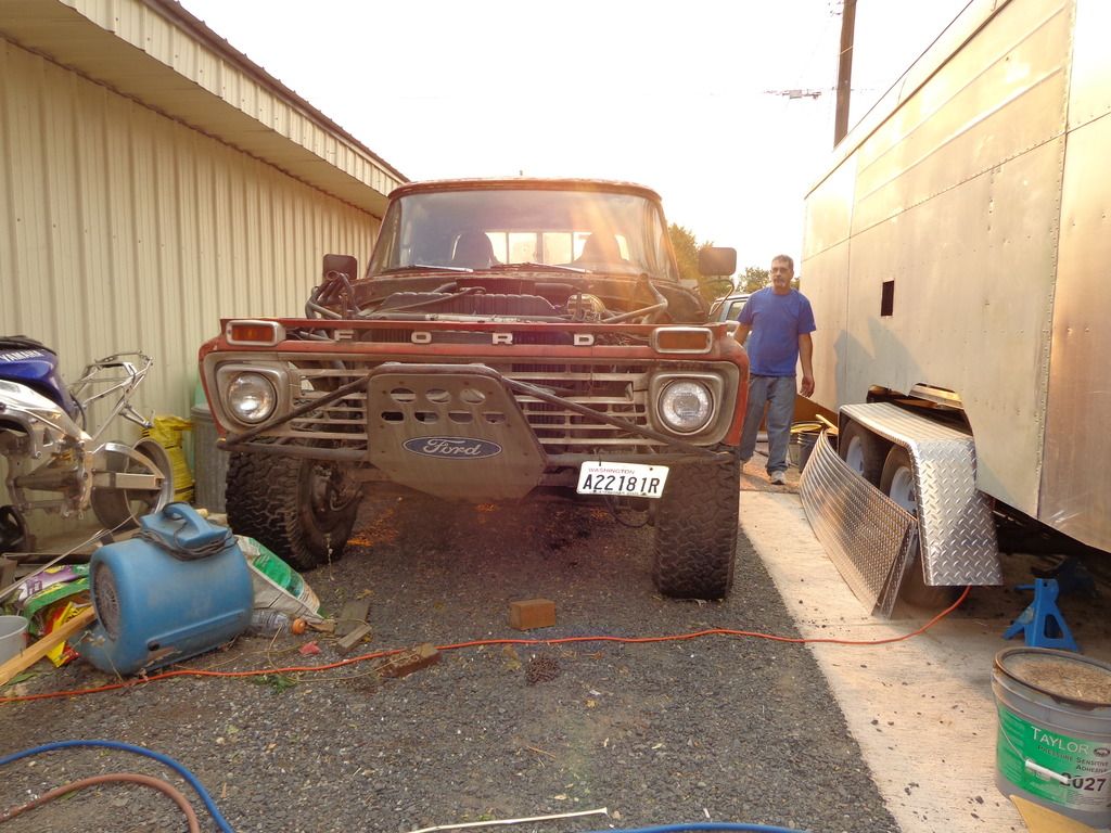

Uberoo Posted September 1, 2015 Author Share Posted September 1, 2015 I took some pics of my friends truck for inspiration.I thought it was a class 8 but its just a chase truck built in the 90's.Still though it was built to 1990's score rules so at the very least its still usefull as a play thing. Quote Link to comment Share on other sites More sharing options...
Uberoo Posted September 1, 2015 Author Share Posted September 1, 2015 More Quote Link to comment Share on other sites More sharing options...

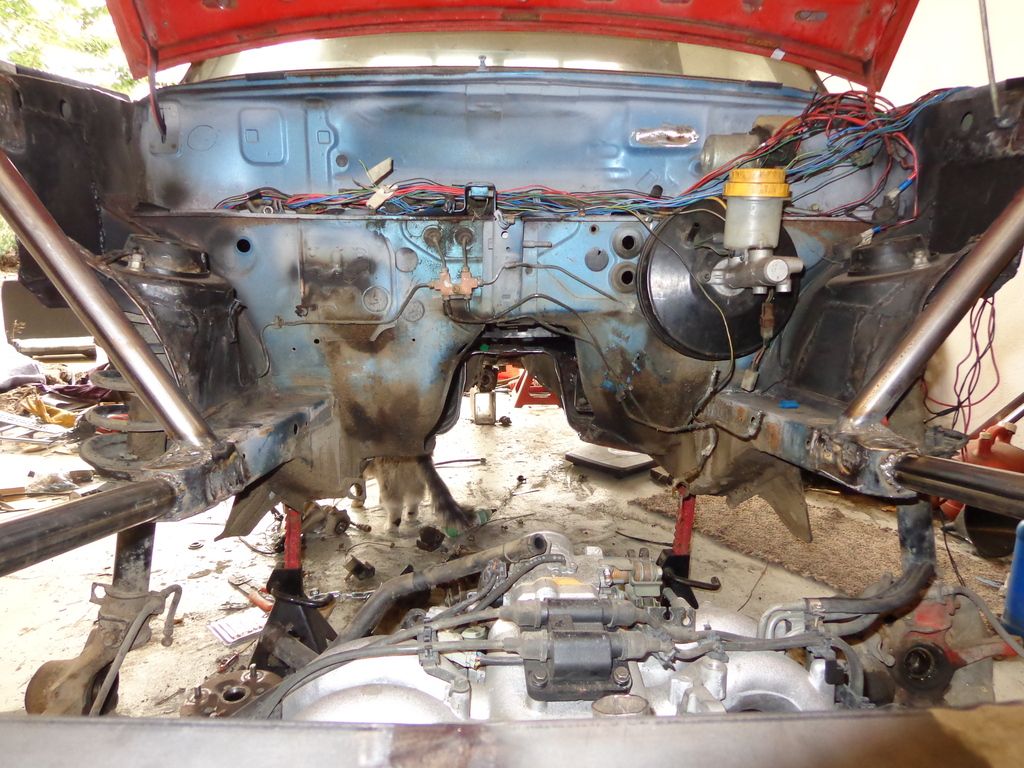

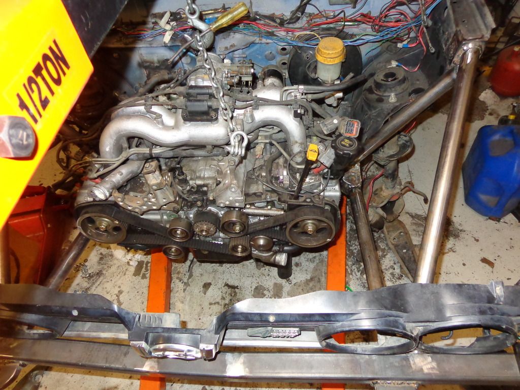

Uberoo Posted September 20, 2015 Author Share Posted September 20, 2015 (edited) So I re-enrolled in college to learn drafting and work on my math while I am there.The plan is get a job drafting at least until I can get a degree in mechanical engineering.Anyway, college started back up and I've been a little busy as of late.In order to even think of building a rollcage I need to get the engine semi-permanently mounted in place to figure out where to run tubes to tie everything together.One thing I didn't like my tcase hatch was how far forward the engine ended up being,because I mounted it 8" above where it normally would have mounted with out moving it rearward.So today I set out to address that and I moved the engine as far rearward as I can,which as it turns out is roughly 5-7 rearward of the original position.It required bit more cutting of the transmission tunnel and while I was there I cut out the original shifter holes on the tunnel to make room for the suzuki samurai transfer case.Here is roughly how far back I can stuff the engine,its about a foot from the where the grill will sit. and there is just enough clearance for starter removal It will require more "frame" modifying and reworking my tube front end because the engine will need to sit offset to passenger side a couple inches so the starter can clear the brake booster,and the entire combo will need to point toward the center of the car to keep drive shaft angles from getting too extreme. Next project I'm gonna write down everything I want to do and how best to achieve those goals before I ever pick up the torch/welder.I'm tired of having to redo my previous work. Edited September 20, 2015 by Uberoo Quote Link to comment Share on other sites More sharing options...

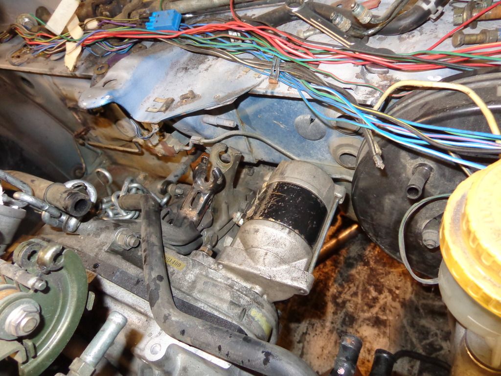

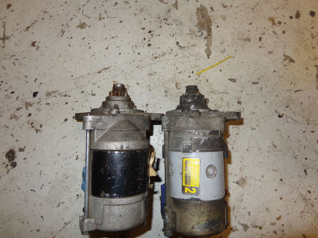

Uberoo Posted September 20, 2015 Author Share Posted September 20, 2015 (edited) Pictured is a EJ22 starter,and right now I'm trying to figure out if there is any reason why it can't be used because it is shorter (and fatter) than an EA starter.I lined up an EA82 starter and the EJ starter and I'm not really seeing why it couldn't work. Both pinion gears seem to stick out the same length(pushed out/sucked in) from the mounting flange,and both have 9 teeth. Edited September 20, 2015 by Uberoo Quote Link to comment Share on other sites More sharing options...
