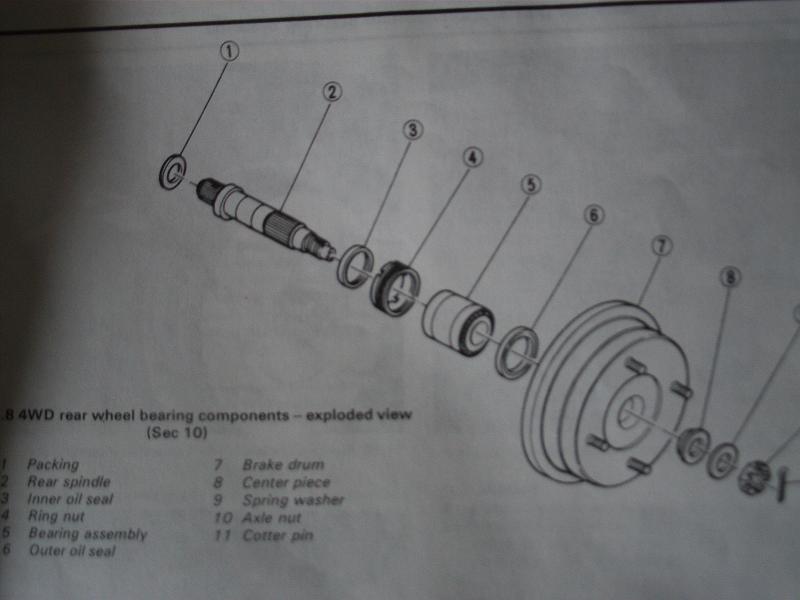

All the axle stub pictures I've seen on here, none of them have this rubber piece that mine does. Right where the axle stub mates with the cup, there's a thick rubber ring pressed in there as well. Am I going to be alright without this rubber ring, because it's pretty much destroyed now....I'm thinking it was there as a vibration damper and maybe a dust cover for the bearings. Little concerned about it.
Thoughts? Experiences?

I wish you luck with your axle replacement,fighting rust can be a bitch without a vice to hold things in place.
As far as the rubber "packing" goes, the driver side rear axle on my EA81 had it but the pass.side did not.
It allowed the cup to have some play on the stub, causing a clucking sound from the rear while going over bumps.
I simply cut the lip off the smaller end of an old C.V boot and used that as the "packing".
It would be best to find an actual bushing or o-ring, But if you have your old boot and a way to cut it, its a free source.
Good luck!

81EA81, thanks for the blowup. Packing, eh? Interesting thing to call a little damper. That's a great idea about using some of the boot, I have what's left of the old boots to chop up, plus the big "rubber band" type rubber that went over the clamps on the original axles, so that's great food for thought, thanks for the idea.
grossgary, I understand what you're saying, but I don't think that's the case here. I haven't gotten the cup to budge a millimeter. Nothing, nada, zip. It's stuck on there damn good.
I'm done with it though, and I got my answer about the "Packing" rubber on the end. Now it gets handed over to somebody in a shop. Lacking a vice was probably my downfall this time. Hoping whomever has their hand on it next doesn't eff up my axle stub while getting it all apart.
Thanks for the advice and especially for the exploded view.
