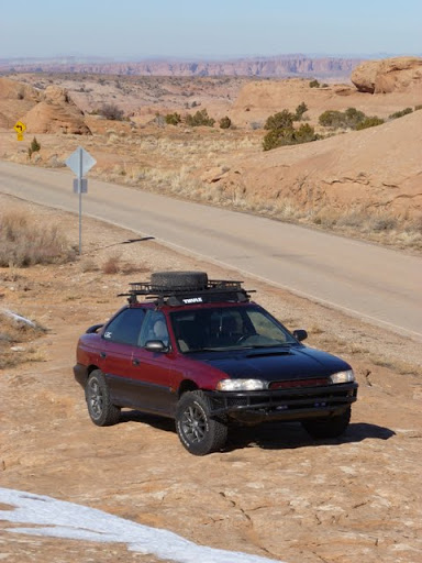

Per JesZek, I have a 95 legacy Sedan, 2-tone maroon and black.

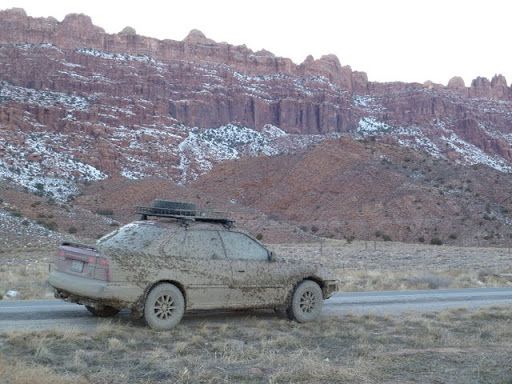

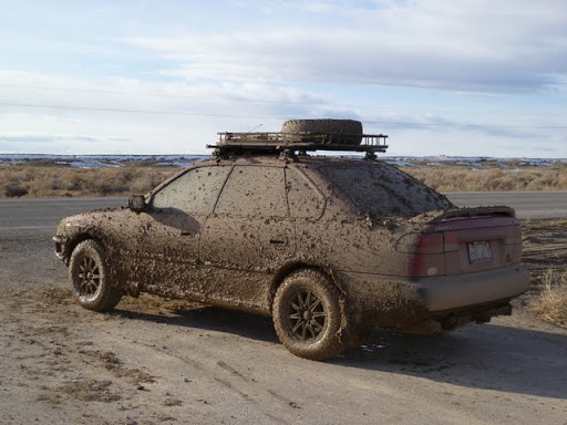

LoL! ... :P ... I always thought it was Red, Dark Red, covered with Mud / Dust \ etc from Offroading, which made it Look like Maroon...
My mistake...
Kind Regards.
HAHA!
I can never remember if its Mica Ruby or Ruby Mica, its color code 947, but now it's 2- tone with satin black... well 3- tone with oxidized satin black and the hood  B)
But More commonly looks somewhere between those and these
