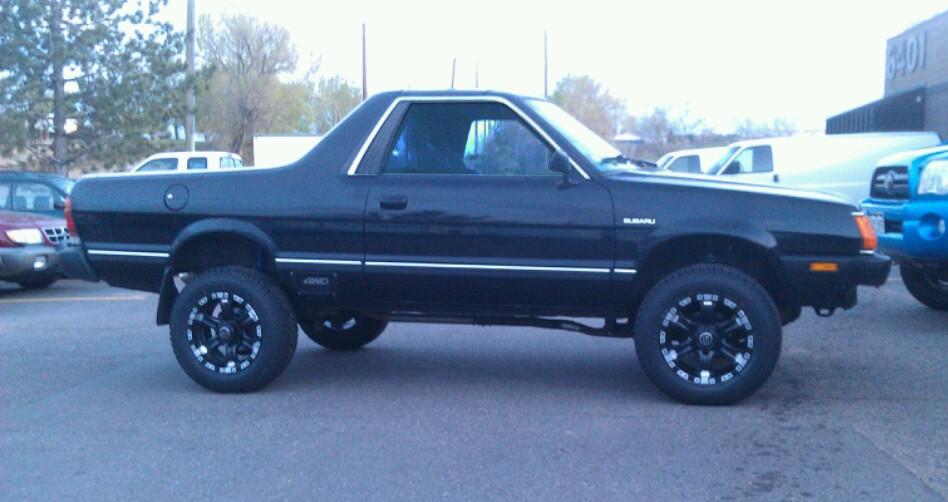

#11 ragingbull
ragingbull
    Advanced Member
  • 116 posts
  • Hamilton Ontario
Posted 17 June 2014 - 05:29 PM
Looking great guys, thanks for the info!!!
I'll try for the 205 / 70 / 15's and go from there.. Here are the the rims I picked up!!! Tires are 235/70/15's so I should find something smaller till I feel ready to start cutting!
