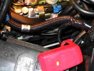

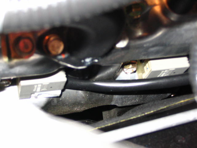

Got a question. I have a 05 Outback XT. Unlike my 91 Loyale where the plugs stand staight up. There is no room to access them XT plugs. Maybe from under the firewall behind the tires? Does not look rosy.
of the 2 photos one is a close up of the drives side plugs (weird eh) and the other a distance shot so you get an idea (weird eh?).
Any Idea?

Remove the battery and the coolant bottle. Take the motor mounts loose and shift the motor. I haven't done it yet, but that is what I had to do to one WRX that I couldn't get to a plug. I am sure it is going to pay close to 2.0 hours. You will also need a socket with 3 bends to it but not 3 wobbly extensions.

BTW, the XT uses direct ingition, therefore has a coil for each plug, mounted on the valve covers. You'll have to remove the coil pack before accessing the plug. :-\
