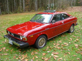

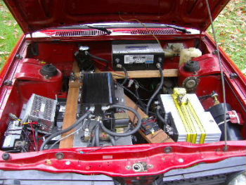

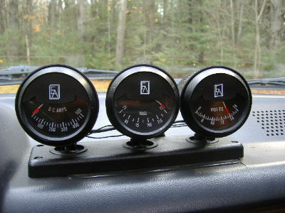

Hey folks- finally posting some pix of my project. I've driven about 800 miles as a full electric vehicle. It has great acceleration and a top speed of around 100mph (i've been 85 with plenty left) range about 40 miles. It costs about a penny a mile in electricity. 700 lbs (10x70) of AGM 12 volt batteries wired in series for 120 volts. 500 amp controller. We are talking 60000 watts here people. It is a smooth ride- I can leave it in third and drive it around everywhere like an auto, if I want better range or power i can shift the 5speed tranny. Adapter plate is the one custom piece (other then mounts etc.) that attaches the new motor (140lbs) to the transmission. I didn't weld anything- used angle iron for the motor mounts and oak beams for the lower battery mounts. The top wood is mangaras some tropical stuff i had lying around, would have preferred local wood, but it seemed like a good way to recycle it. In maine we can choose green power for our electricity which is 80% hydro (free flow, fish ladder) and 20% wind. Low rolling resistance sumitomo htr 200 tires. Synthetic tran fluid. No oil, no coolant. No filling the batteries (sealed). Unplug and peel out. Vaccum pump and resevoir to maintain power brakes. Dc converter that steps 120 down to 13.8v instead of an alternator. I am very happy with my car. And now electroautomotive has an adapter plate design for this transmission so if one of all yall wanted to build one it would be easier. Car cost about 2000, components about 6000 (mostly brand new) batteries and misc. another 2000 so 10 grand which is what I sold my insight for. The only thing I cut out were the mounts for the gas tank, which i still have. Let me know what you think or if you have any questions. Keep subin!

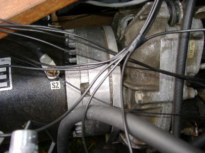

"can't you just put the tranny back in and measure?" the transmission only mounts toward the rear so without the engine attached i don't know what height the front should be. sorry if this doesn't make sense, i'm confusing myself as well. i'll probably just end up winging it, making a temporary forward mount that is adjustable either way (jack), a block of wood, a bundle of twine and i'm off! i looked at using a brat as a donor car for the same reasons but the extra drive shaft really sucks up the energy/range. my front wheel drive car came with factory snow chains so i'm hoping traction won't be too much of a problem. besides if i had a 4wd electric subie i would have to thrash around the woods with it and it wouldn't be good.
all the parts for my conversion have finally trickeled in. planning on a 144volt 550amp conversion which is 79200 watts X .00134 (conversion)=106 horsepower. but because it will be heavier (12 lead acid batteries) it should have similar performance as a gas version. i'm trying not to look back, but i could be driving the sube around now if i didn't go tearing it apart.:-\ anyway, in my dismantling fervor i neglected to measure the position of the transmission against a fixed point, so now i don't really know how high to build the front mount for the electric motor. i'm told i could screw up drivetrain angularity or the shift linkage. anybody ever deal with this- maybe in an engine swap or something? is there some rule of thumb?
