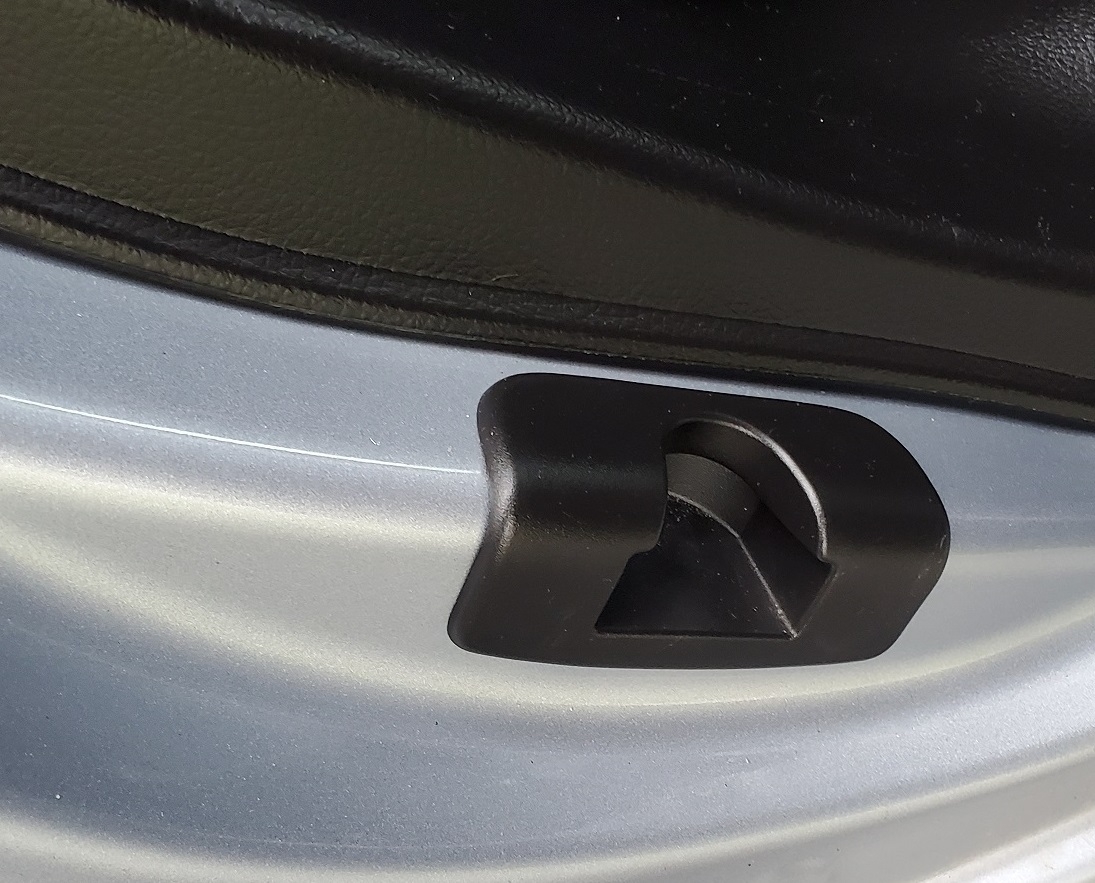

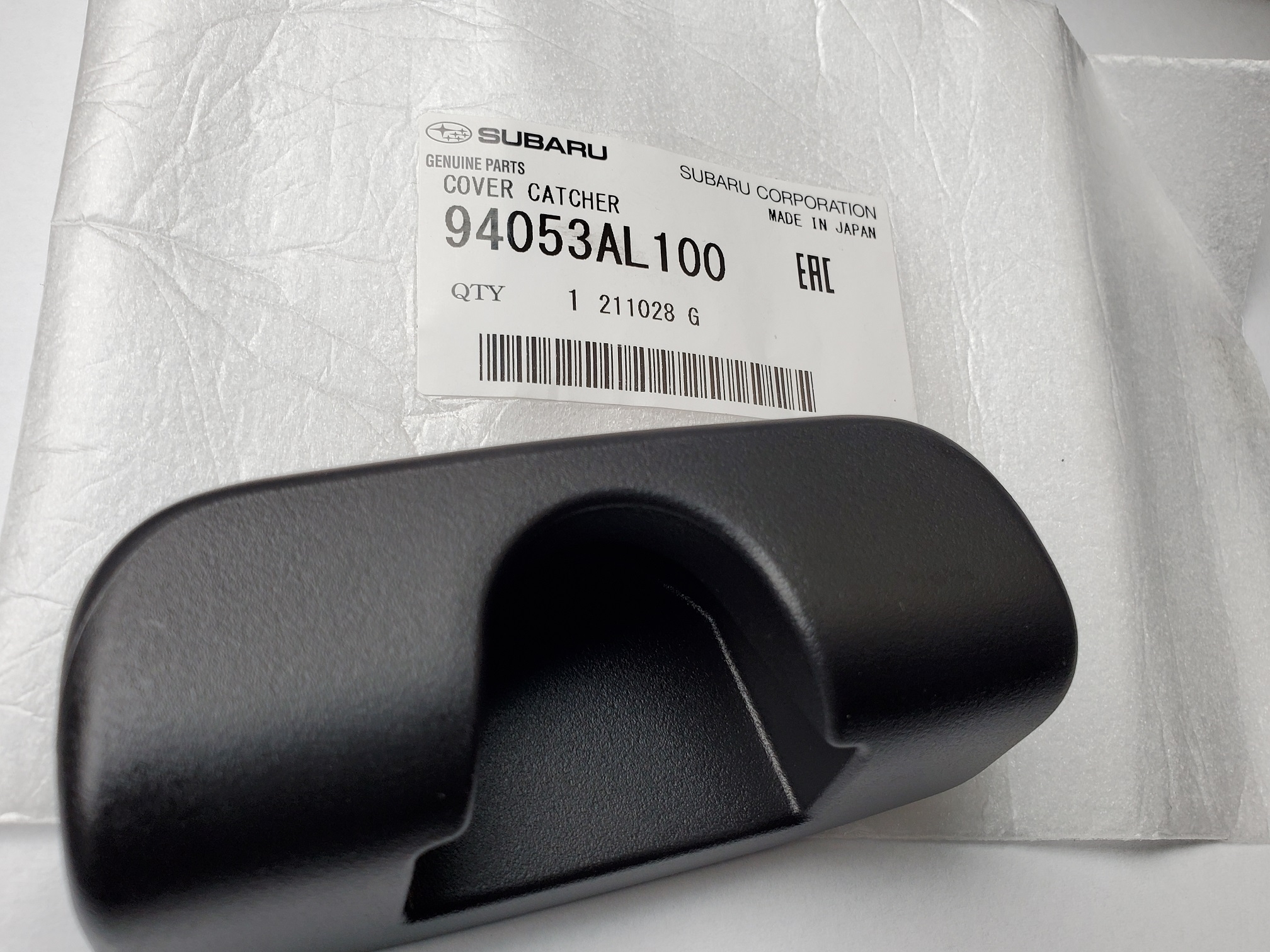

Does anyone know what this is?
I have a new to me 2017 Crosstrek. One thing I need to take care of is this. Passenger side rear door sill has this plastic piece that a stud on the door fits into, while the drivers side has a hole. Not sure what it does or what it's called to look up ordering one. So does anyone know what the plastic part is, or what Subaru calls it? Better yet any idea of a PN? Eric

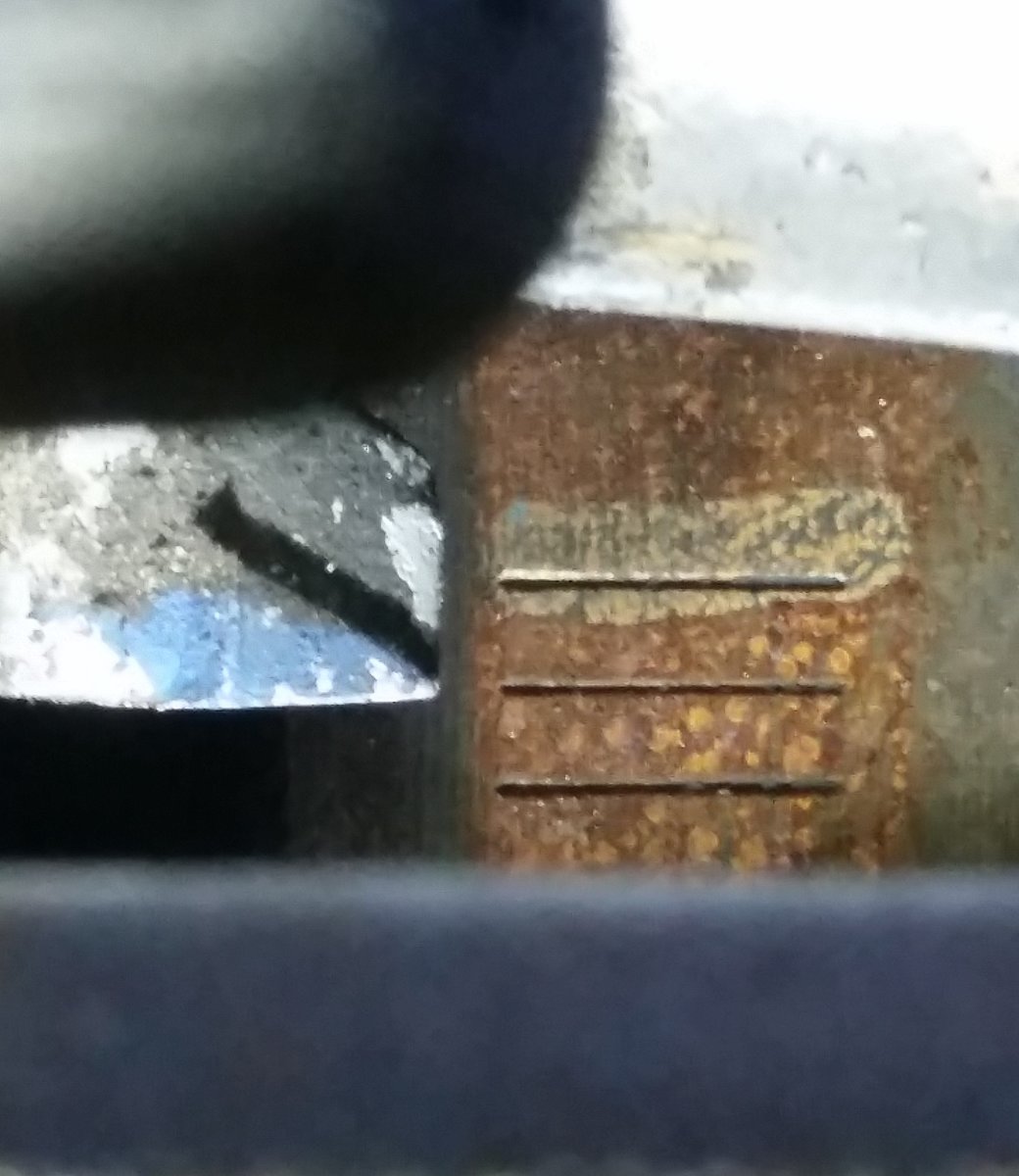

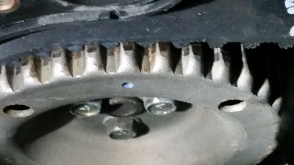

Guessing I'm 180 out?
Drivers side is up. No error there. Found a vac line off, and when I went into old school mechanic mode and started checking plugs for fouling I found my plugs desperately needed replacing. Replaced plugs, connected vac line and it ran pretty good. Hit it with a timing light (with the green plugs connected) and set to 20 BTC. Runs pretty good now. Have new cap and coil for it to put on next, since both are likely 30+ years old.
Ok so I checked timing again. This is where I have it. If anything is out, it looks like maybe a half tooth on passenger side. Curiously, it will not start now. I read another thread about checking for #1 TDC, and when I followed that, with my cam marks pass side up and out approx 45 deg. drivers down and out, my rotor is pointing to #1. I did notice some flaky white deposits on the posts inside the cap, which I cleaned off. Thoughts?? Eric
Thanks Ferp, I'll look more closely. Might have moved when I adjusted tension. I absolutely did do the 360 rotation after doing the drivers side belt.
So belts are in, my trusty GL did start, but very rough and won't take throttle. So I'm guessing I'm 180 out. Will these engines start like that? Or is that more symptomatic of being a tooth or so off? It looked fine to me after I carefully followed the advice and videos posted here. And if it is 180 out, can you just rewire the dist cap to correct? Eric
