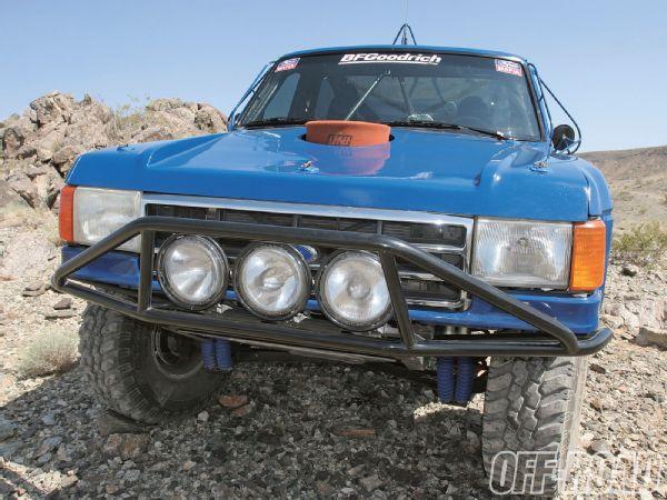

  16. If you look at a stock hood it is reasonably flat, then it bends downwards to meet the grill.I'm wondering if anyone has ever modified the hood so it more or less goes straight from the windshield down to the grill without the downward bend at the front.The old baja trucks based off 70's fords and what not had something similar to what I am describing because the factory hoods on those monsters was 6-8" taller than the grill. Essentially it ended up looking something like this: the hoods were modded like that,because it would give you an extra 5-6 ft of visibility to avoid something.5 ft of extra visibility offroad would do wonders for showing the trail up a head. With my brat at best I could drop the hood only about 2" at the front. Basically cut out the large section of the hood in the middle,then cut alone the tape line where the hood starts to bend down.flatten the bend out and reweld the center piece of the hood so its a straight shot from the windshield to just above the grill.Its the basic gist of the idea. Yesterday I saw an old class 6 baja chase truck at a car show and I liked how the hood on it looked,and it got me thinking again.
