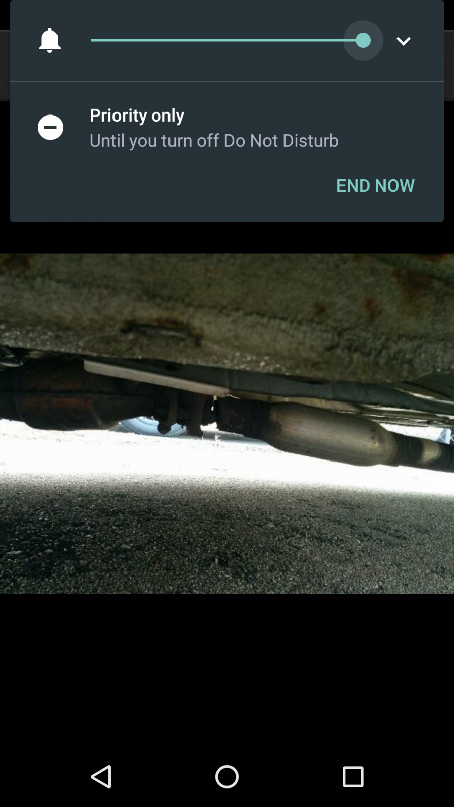

Update The pipe is horribly rusted (he showed me) in a few locations and there is a leak at the hanger. He considered putting a piece of pipe into the cat flange (I think) and then into the rusted out pipe where he could get a good spot. He said it may hold out for a couple weeks. He priced a cheap pipe and flange assembly with gaskets (about 200.00) and he said about 45mins labour. Stainless steel option was about 275. I asked him about running a straight pipe and bypassing the resonator (as mentioned earlier in this post) He said he could do stainless steel that way for about 200.00, but I may hear some louder exhaust noise at high RPM's. Decided to go the straight pipe in stainless, will see how that goes... Seemed better than another crap pipe and if I can't stand the sound (doubtful, that is what the radio is for!) then when I have a little extra cash I can always switch it back out for a stainless steel with resonator. As for the cat, he showed it to me, said at least on visual inspection it looks great, although there are 2 cats and he can not see the first one without cutting into the pipe. Thanks so much for all of the advise, through the years everyone has always been super helpful. Denise 1995 Subaru Impreza 2001 Subaru Forester 2002 Subaru Forester
Have an appointment this afternoon with a local exhaust shop elite stainless steel. Just you said he thinks just a small piece or pipe welded in should do at the cat. He will look at the second spot after the reasonator and see what can be done there as well. Tried to look into the cat for any signs of damage, but to such luck. Will keep you posted on any updates, I am sure they will mention if there is any cat damage.
Working on posting pics, for some reason they will not upload... I don't know enough about cars so it is hard to describe... It is broken right after a larger piece that is just before the drivers door. Then the pipe goes on to another larger almost pill capsule shaped piece... As soon as I can get pics up I will. Thanks for the help!
