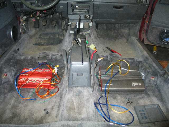

Good sugestion on the AA battery. Thats what I use sometimes. I recently installed a system in my 88 Gl station Wagon, see link. First off the common ground return for the front/rear speakers needs to be eliminated. All the new head units can compensate for this but it could damage your nice new head unit. The cheap way to fix this is to cut the wire on the front speaker ground and just route a new wire to the dash, pretty easy to do. Another good bet is to rewire the whole system. The reason a converter plug is hard to find for these cars is that the common ground is a known issue and the good radio shops won't sell you something that will frick up your new radio. In cases like this its nice to just crimp female 1/4" slides to the dash harness and male 1/4" slides to the stock connector jumper that come with the new head unit. The factory speakers were 10W, paper coned POS. I'd replace them with the new radio. http://www.ultimatesubaru.org/forum/showthread.php?s=&threadid=13063&perpage=25&pagenumber=2 My intallation Anyway, my .02 cents worth. -

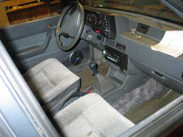

Well, since I got the car tuned in and running with the new 5 speed D/R tranny I decided to focus on the interior. I removed everything, including the door panels, seats, trim, and carpet. I found a couple of places where inspection covers were missing and water got in; looked recent. I made new covers for the inspection plates under the rear bench seats. Anyone know what they are for? I made then out of light sheet metal and stuck them on with roofing caulk. Now I wanted a radio, this car came with a non-working radio. I removed the stock radio speakers, 10W? Wow, now that's cheap. I installed 220W 4-way 6.5" speakers. Made a subwoofer box out of the rear center stowage compartment. Used hinges I salvage from the tranny donor car at PAP, cut a 1/2" thick birch board 12.5"X39", attached the hinges add weather striping to the top of the box cut some holes for the two 10" 600W sub woofers. My XM receiver fit in there too. Added a 4-way high amp sealed connector so I can just unplug and remove the woofer assembly and re-install the sheet metal door in seconds. I've installed a 444W 4 channel amp for the door speakers under the drivers seat, a 760W 2 channel amp under the passenger seat for the woofers. Got an Alpine head unit, Aux input plugs for my MP3/WMA player and XM hooked up. I stuck a low profile XM antenna on the roof near the back. Might not work too well when I got my skis up there. I cleaned the carpet, washed it on my deck by hand several times. Lots of dirt in there. The four hold down screws were all bad so I installed new hold downs. Found a gray interior at PAP to replace a couple of busted trim pieces. Had problems with the radio installation. I had to install it sticking out 3/4". Is there a depth issue with these cars? What can I do to recess it in the dash? My power steering was squealing real bad, a PAP pump fixed that. A new 185/70/13 spare fit nicely under the hood. The test drive with all the interior parts installed reduced road noise so much! After two weks of work I can now start to have fun driving it. What kinda gas milage should I expect to get? -

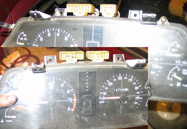

Attached is a picture showing the two gauge clusters. The 1985 5 SPD cluster has a different conector (top right) then the 1988 gauge cluster. Anyone know if a 1988 5 SPD cluster has the right connector (top right) or is this a auto/5spd difference. I also found out that the engine harness was common, 3AT/5SPD, but different instrument panel harnesses were used for an auto. Too much bother to change this out. -
