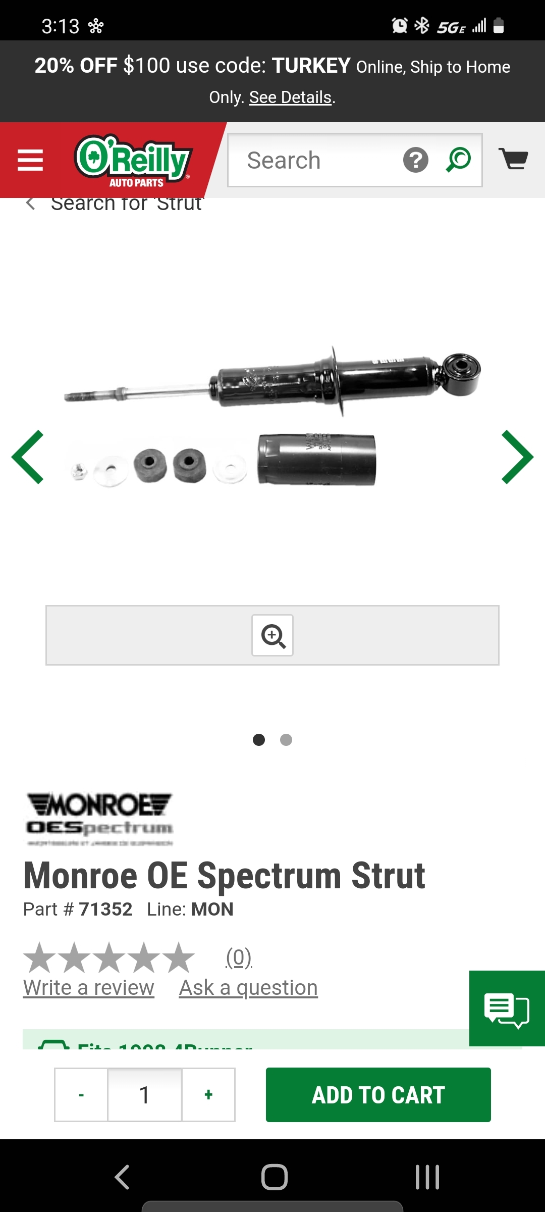

Well I wasn't 100% till you mentioned the reverse thing. Yeah idk why it does that. Did it the whole time I had it. Sometimes reverse just wasn't there. Oriellys has those struts in stock. Sorry I think I said they were 93, it's 98

just out of curiosity, do you have a picture of the car? or maybe the strut itself?
