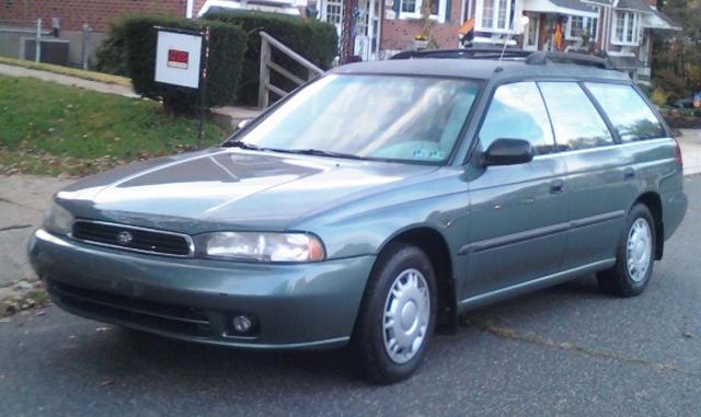

95 Subaru Legacy Wagon
Late addtions to the thread but here's a couple shots of my Legacy. Am getting settled in, ironing out some issues. So far, so good. After years away, it's good to have a Subbie again.
