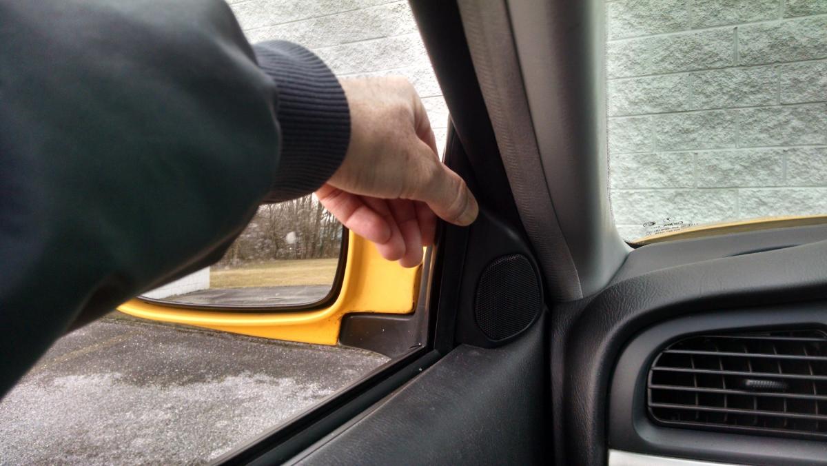

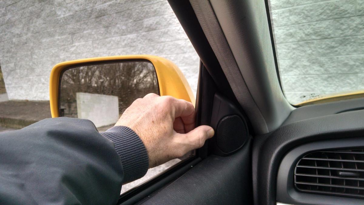

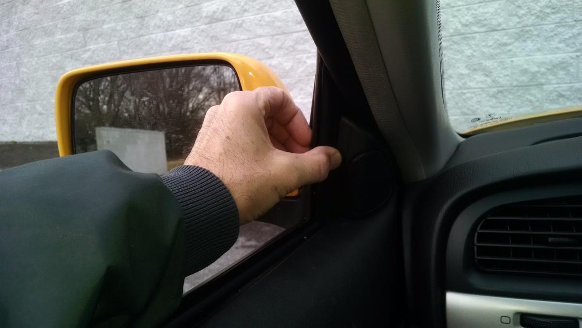

driver's window wind noise fix
jseabolt replied to gbhrps's topic in 1990 to Present Legacy, Impreza, Outback, Forester, Baja, WRX&WrxSTI, SVXPhotos: Actually it's easier if you open the door, roll down the window and stand on the outside of the door while squeezing.
jseabolt replied to gbhrps's topic in 1990 to Present Legacy, Impreza, Outback, Forester, Baja, WRX&WrxSTI, SVXThe fix worked on my Baja! Thanks!
