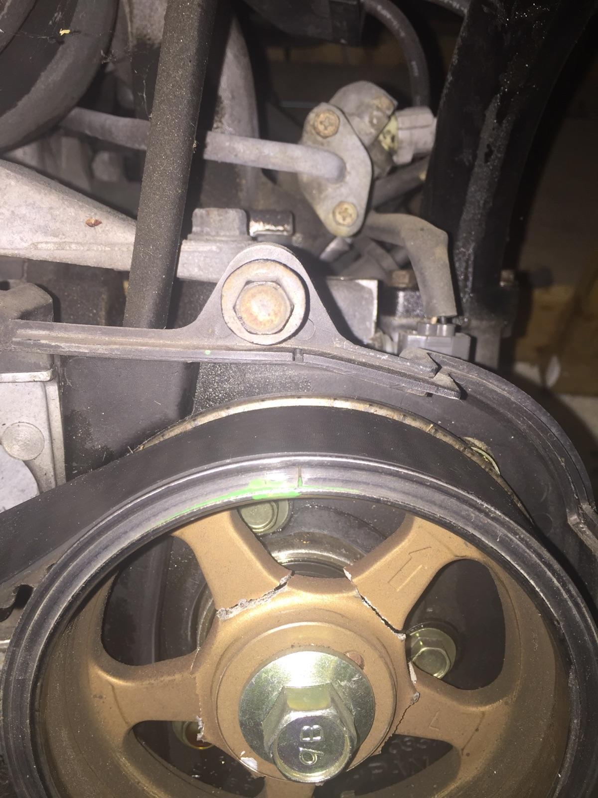

  2. Hi guys. So I'm looking to purchase a ej22 that came out of a car that was in a 25mph rear ender where the truck bumper went in far enough to break the cam pulley completely. I'm having a hard time finding a good engine here in Colorado so when I saw this for 300 bux and only 112k miles on it I thought this would be a good deal. Do you think the impact could have hurt the cam itself? Its a 97 ej22 so it is a interference engine but the timing is still on or at least that's how it would seem.
