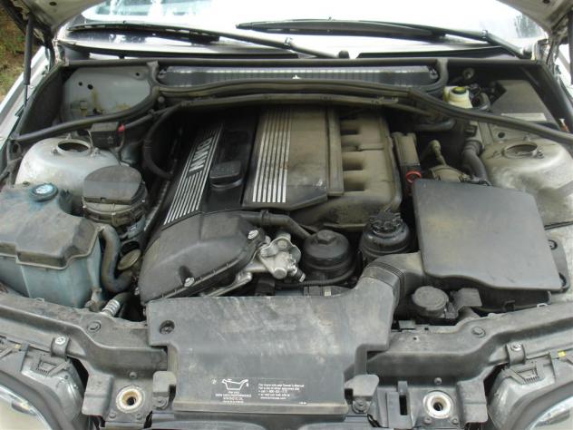

I finally found time to do a few things on the car -- replaced oil & filter, cabin & air filters, and spark plugs. The engineers made these tasks very easy to perform on the straight 6, or so called "slant six," especially for a 3.0 L packed tightly into relatively small chassis. I've had plenty of experience with other cars where the engineers didn't seem to put much thought or care into how folks would maintain and repair their final products. The last oil fill was in service for 17.5K miles, and consumption was probably the 2 qts. that I added as I doubt the po ever topped off. The filter cartridge still looked good (no sludge). All I need to do now is to find some time to do the clutch.
