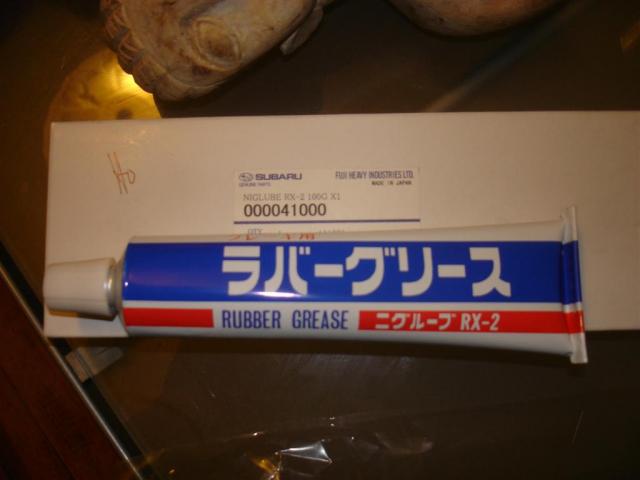

Finally, Niglube RX-2 Part#000041000
hohieu replied to hohieu's topic in 1990 to Present Legacy, Impreza, Outback, Forester, Baja, WRX&WrxSTI, SVXLoyale, I'm guessing you thought you were on the wrong forum, huh? Agreed, it's a pretty literal translation for the product. I should also say that all the other stuff I've tried has swelled the brake rubber and hardened over time. I'm sure there's an aftermarket equivalent out there somewhere, but since Akebono's caliper design is the only one I know of that uses the rubber bushing at the tip of the lock pin, I'd been looking for this JDM/OEM grease for a while.
I tried several different synthetic non-petroleum based caliper greases for the sliders and they've all let me down. Finally found this at Subaruparts.com for $12.60 + S&H. It comes in a 100g (~3.5 oz.) tube.

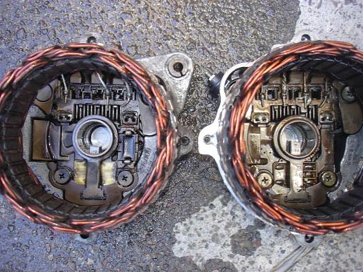

99 Forester Alternator & 98 Forester donor
hohieu replied to hohieu's topic in 1990 to Present Legacy, Impreza, Outback, Forester, Baja, WRX&WrxSTI, SVXI opened them both up, and besides the front casing, bearings, and brushes, they're actually quite different. The IC regulator, rectifier, and winding connections are all different. All the wear items still seemed fine on the '99 alt. so I'll just reassemble and bolt it back into the car. I'll see if I can get a 2-spade pigtail and put the '98 alt. in the spare tire well just in case...
'99 Forester with 170K miles, original alternator So I guess I'm in it for the long haul: just replaced the clutch and ball joints and will be doing the struts after the winter. I'll be doing some long road trips for the holidays and was thinking about taking apart the alternator and perhaps swapping in some parts from a donor low-mileage unit off a '98 forester. They're not interchangeable. The 98' DOHC alt. has a 2 spade rectangular plug while the '99 SOHC alt. has a 3-spade oval plug. I suppose I could also splice in another pigtail to accommodate the '98 alternator. In any case, the bearings and rotor are easy enough to replace, but some soldering is required to remove and test the regulator and rectifier and to replace the brush. Are there any parts that are more prone to failure? I'd rather not have to disassemble the whole thing. I'd appreciate your advice and guidance. Thanks.
