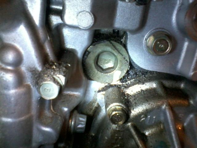

Anyone have the torque specs for the oil pump bolts and cam gear bolts? BTW anyone who may be reading this for their own info, when replacing the front crank seal on this engine, it is easiest to remove the seal after you remove the oil pump. It is easier to re-install the seal after you have the oil pump bolted back on. I boogered the first seal when I was trying to put the pump back on. Luckily I had a second one laying around from a previous accidental overpurchase.

I pulled the oil pump and discovered slight seepage around the front crank seal and suspect possible seepage at the top right of where the oil pump mates to the block. I plan to replace the front seal, o-ring and re-seal the oil pump to the block. Anything else I should do while I have the oil pump off? Where do I get the anaerobic sealer? Will rtv work here as well? Torque specs on the oil pump?

The cam seals are dry all around, as well as the front crank seal. . Is there something higher on the block that could be a likely leak point for the oil to run down where I am seeing it?

Ok, giving it a try through manage attachments section. Looks like it works as a thumbnail. Good enough!

When I click on that I get url location message. Does the image have to be posted elsewhere on the internet before I can post it here?

I updated my avatar to a picture of the leak. How do you insert a pic on the post?

Ok, I have it all apart and I have a mystery oil leak that I have not encountered on any of my 2.5d engines. The oil appears to be coming from just above the water pump and slightly to the left. There is a crevice there and what appears to be an allen headed plug in the area. What is leaking and how do I fix it?
