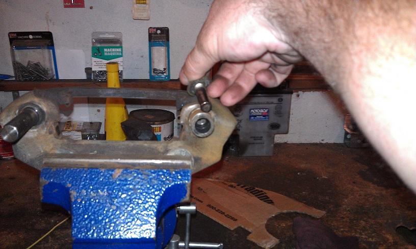

Managed to get new bushings from the local Subaru Dealer. The parts counter guy (younger than the Brat) was surprised that they had the parts in their computer system. They only cost $1.00 each. I had to order them, but they arrived the next day. Will be putting the whole thing back together this weekend. Thanks for the help and suggestions, everyone. Allan -

Turns out that I do not have that sleeve. Pulled the other caliper off, and there is no sleeve in it, either Now, I have to figure out where to buy them... Any suggestions? Allan -
In inspecting the front brake pads, I found that one pad was severly worn compared to the other pad on the same caliper. Obviously, the caliper was not self-centering itself on the Caliper Bracket. I removed the single bolt (pin) that holds the Caliper onto the Bracket and found burnt rubber all over the bolt. I pulled the Caliper the rest of the way off the other guide post (which is attached to the Bracket) and found that it was clean. I presumed that the burnt rubber was gumming up the Caliper and not allowing it to slide on the Bracket. I removed the Bracket as well and tried to clean everything up. In doing so, I have found that the bolt (pin) has a smaller diameter than the hole in the bracket. I have a picture attached, showing the diameter difference. Is this normal, or should there be something else in there to keep the pin from moving vertically in the hole? As a side note, the guide pin at the top had a rubber boot over it. The guide bolt (pin) had the remains of a rubber boot over it. Part of it was apparently melted to the Bolt (Pin) and in the hole. Any advise would be appreciated. Thanks, Allan
