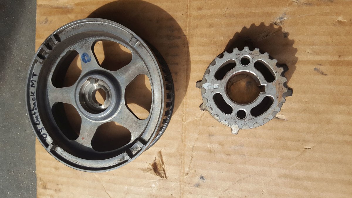

36-2-2-2 trigger wheel image??
1197sts replied to Step-a-toe's topic in 1990 to Present Legacy, Impreza, Outback, Forester, Baja, WRX&WrxSTI, SVX
