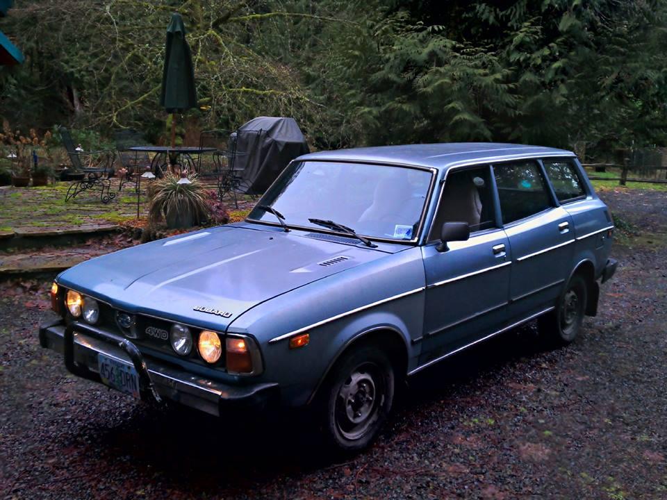

mine is a 4wd and i now will be on the hunt for struts. i work at autozone so you would think i could find some... but no :/ here is a side pic -
