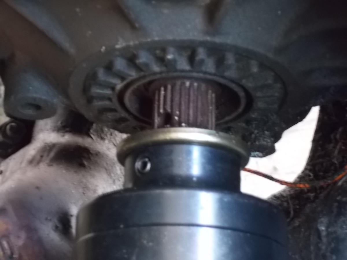

  5. No, this is entirely my fault. I put this axle on about 3 wks ago, evidently drove pin through half shaft, missing stub entirely. Drove it around for several hundred miles this way, with only occasional clunk from front end. When I found this, this morning, I tried skinning the halfshaft back far enough so I could see light through the roll pin, drove out what I thought would be pieces, but the pin came out whole... Skinned the halfshaft back where it belonged, drove in a good roll pin, and Bob's your uncle.. I love Soobs, no matter how ham-handed the mechanic,, they keep on truckin'.. bk
  6. Axle is 2 weeks old, used pin supplied..
