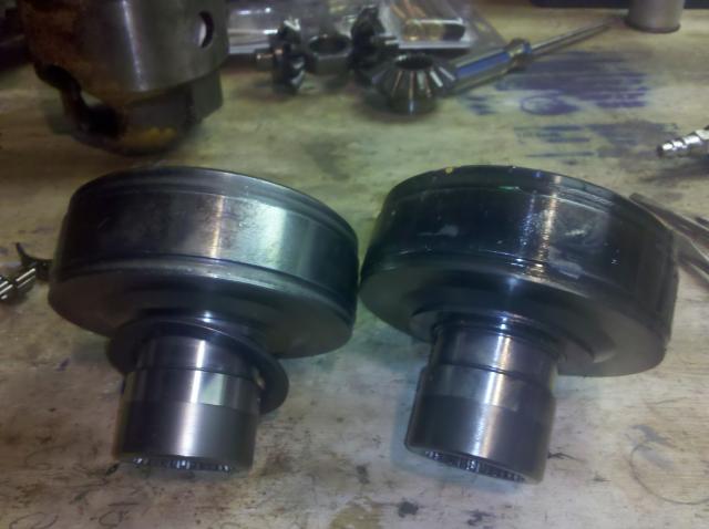

Viscous Coupling Questions
Tmb9862 replied to Tmb9862's topic in 1990 to Present Legacy, Impreza, Outback, Forester, Baja, WRX&WrxSTI, SVXWell a few swear words and about ten hours (including some breaks) later the new coupling is in. She drives well now with no more binding. The old one was defiantly a little burnt as you can see. If I had to do it again it would probably be a three or four hour job having learned a bit. Those roll pins suck and aren't even worth trying to punch out by hand. The air hammer got them right out and next time I'll go right for it instead of wasting time doing it by hand. The same goes for getting the knuckle off. You can play with the stupid thing all day and it won't go anywhere but the air hammer knocks it right off. I wasn't thinking straight and removed the reverse light sensor. I then spent half an hour trying to figure out why it wouldn't go into gear. Then I removed the whole cross member again and disconnected the linkage to isolate the problem. Only after I gave up an took a half hour break did I come back, look in the parts box and see that washer staring at me. That cost me over two hours from a stupid mistake. The welds nuts on the transmission mount (I think that's where they were) broke on me. I couldn't find any suitable replacement nuts and bolts in my bolt bucket so to save a trip to the hardware store I re-welded them. One of the transmission mount bolts also snapped off in the tranny. I didn't even bother with it and have three bolts in there. I'm going to have to drop the tranny to do the clutch in the next few months so I'll weld a nut to it and pull it out when the tranny is down. Other then that it went pretty smoothly and I just took my time and kept everything organized. Some of the replies here and articles on this bored defiantly helped. And special thanks to GeneralDisorder for selling me the new center differential.

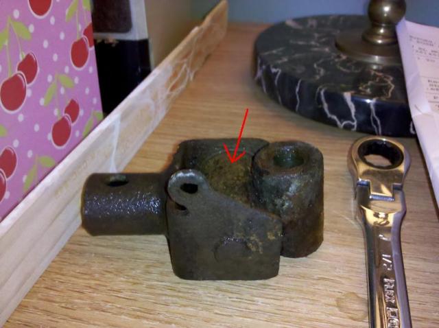

Another shifter bushing question.
Tmb9862 replied to Tmb9862's topic in 1990 to Present Legacy, Impreza, Outback, Forester, Baja, WRX&WrxSTI, SVXThat piece is from a 97, mine is a 96 Legacy Outback. The piece I want to remove and replace the bushing around is identical to the one in my picture. To me it looks like it's a rivet that would have to but cut, knocked out and replaced with a bolt. I'd rather change the bushings then buy a new piece if they are available.
I have 96 Legacy Outback 2.2l, 5spd. I know their are a ton of threads on this and I've went through most of them trying to find this bit of information. I need to change out the two shifter bushings in the dog (pictured part) I believe it's called. The pictured one isn't the one in my car, I have the older style but the answer should still be the same. My question is how to change the one with the arrow. It looks like a rivet holding it together. Do I need to grind the head off and replace it with a bolt? Does anyone know the part numbers or where I can get the part numbers for the two dog bushings for the older style shifter (not the one pictured)?
