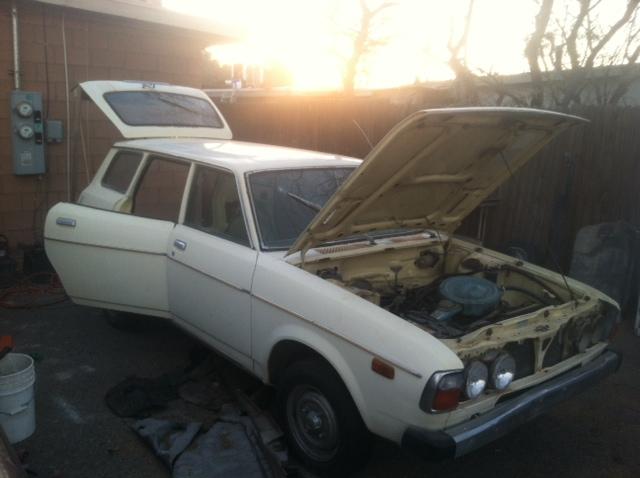

  6. Alright, so It's been a long time since I've looked at this post and figured I would throw up a video and give an update. Finally after all these months I do believe I have the gas tank problem solved thanks to Subaru3 and the guys up at CBASS in Idaho. Here is a quick listen to her running that I took awhile back. The squeal at the beginning was due to a bad water pump which was replaced right after this video was taken. Currently working on the interior until my gas tank is shipped and thanks to Danny for the clutch fan that should be shipping soon.

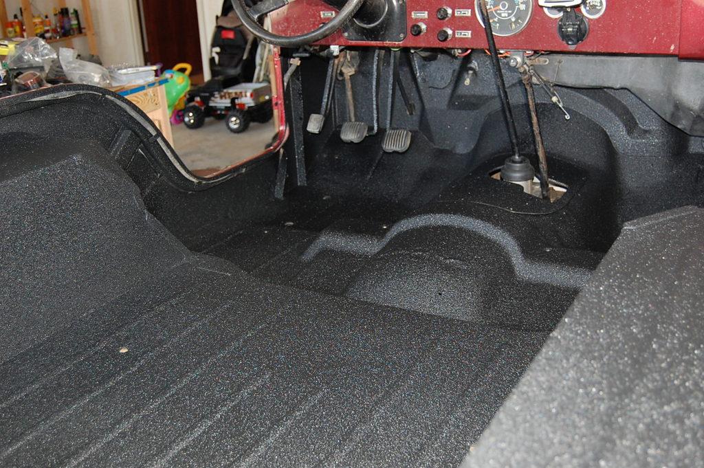

  12. Yeah that'd be great. I'm a little weary of it but we'll see. I'm not in much of a rush as I'm still laboriously prepping my floor pan. I think when it's all said and done I'll have close to 30 hours on getting this raptor liner in. Should be pretty solid though when it's done and a nice upgrade from the crap carpet that was in there. Plus it gives me something to do while I continue to figure out my gas tank problem.

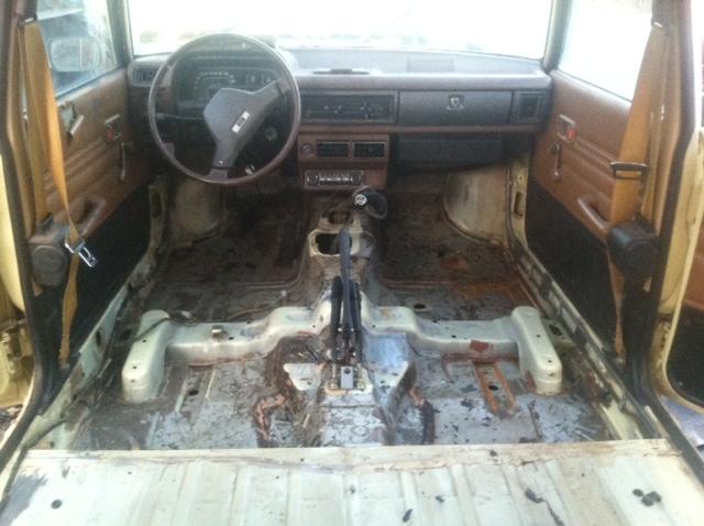

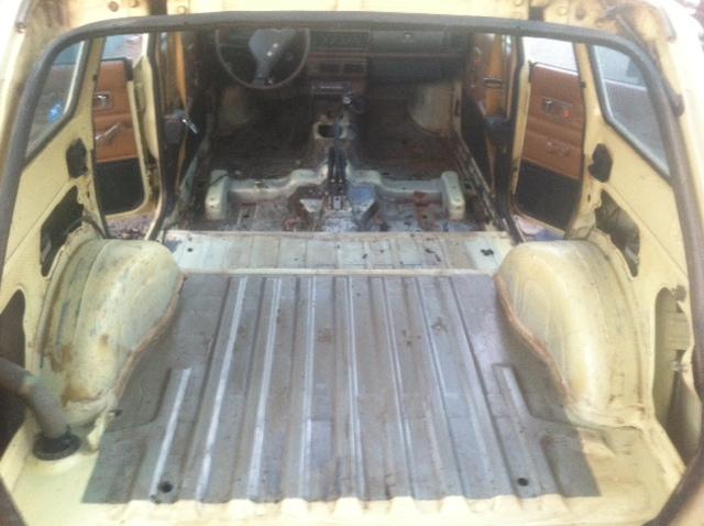

  19. Just thought I would post what the interior of a 78 Subaru Wagon 4WD looks like ripped up. Bought this with ok seats but the carpet was jacked and there was a leak somewhere in the door weatherstripping that was leaking and soaking the carpet. It had been sitting for about 10 years under cover so luckily she was spared from years of rain. I however do not have cover and this is how I found out. Because I ran into some gas tank problems which I am still waiting for the funding to fix I figured I would give her a thorough interior cleaning. This led to the idea "eh, well since I've got not much else to do I may as well pull the seats". So I pulled the seats. The next obvious step would be to pull the carpet right? Done. The carpet was pretty much junk so I was looking at options. I've decided to completely strip the floor pan and primer it and then try a few coats of Raptor LIner DIY. It looks pretty solid on most of the jeeps I've seen on the forums. Obviously this isn't going to be stock but I don't much care about that. I like the idea of the clean floor pan and the lack of moisture buildup possibilities plus it ads a great rust inhibitor to the whole bottom of the truck. Obviously this is Arizona so rust isn't too much of an issue but I am definitely not planning on being too long and it will eventually end up somewhere cold. My main concerns will be road noise and possible heat coming through the floor boards but I'll try to limit that with some aftermarket carpet / rubber floor mats. Worse comes to worse I can get carpet put over it in the future if it really is that bad. Most of the folks who have done it though are happy with the results. Long term it seems to hold up well. Here is the start of in depth interior work. Took a hammer and cold chisel to the floors to remove the sound proofing material and am in the process of using xylene to finish removing the tar. This will take probably another 4-5 hours of prep. Afterwards It will be sanded and one corner of rust patched then primed. I'll be doing the liner on the whole floor pan along with the side walls and up and over the rear wheel wells. Here are a few pics of the progress so far and a pic of what the raptor liner looks like in a jeep. Thought I'd start a thread on interior spaces and see if and what folks have done to their soobs. The third photo is of the trunk space, it shows post Xylene work. Cleaned up really well. The trunk looked just like the front parts of the floor. That xylene is awesome. Also thew in a pic of the whole care... damn near rust free.
