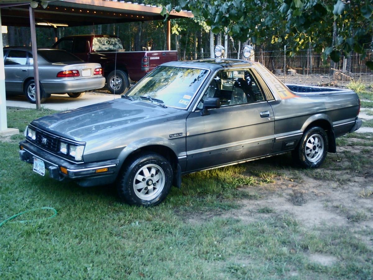

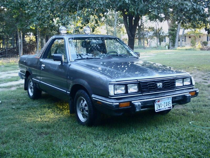

Just installed the lights they are 100 watts each and very very bright. Mounted them on the headrest mount for now until I can fab a rollbar.

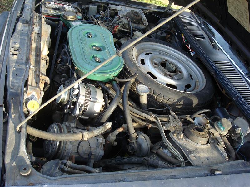

Finally Got My Brat Running But Now It,s Making A Gurgling Noise On The Left (passenger Side )Of The Motor Like It's Getting Hot. So Took Out Thermostat And Wired Fan To come On When Engine Is Cranked, But Still After Running Just A Few Minutes And Shut Off Engine Still Gurgles.Timing Is set Right , Good Water Circulation At Radiator. Flushed Whole System.By The Way Runs Very Good No Smoke And Good Power.
Thanks Everyone, Got Her Running, Now Having Some Cooling Issues. Working My Way Down The List.
