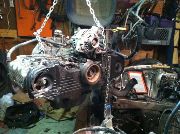

suprunner replied to suprunner's topic in 1990 to Present Legacy, Impreza, Outback, Forester, Baja, WRX&WrxSTI, SVXThanks for all that have replied. I ended up removing the Intake Manifold (IM) (which I will probably do in the future), getting two of the bolts off the plate, and then completely rounding off the remaining two. Bought a Dremel, and cut those babies off. The two bottom nuts for the bell housing were my next nightmare. I couldn't get a good angle on them for the life of me. But I kept my cool and got them off. Again, thanks for all the help! Greg

I'd like to thank all who have been helpimg me out. This motor pull is much different from the Toyota motors that I'm used to dealing with... I ended up pulling the Intake Manifold, which by the way, every bolt was barely snug... I was able to get two TC bolts off, and then rounded two more. I figured I'd start loosening the bellhousing bolts... Got the two on top, barely moved the lower passenger side, but now it's starting to round. I'm using 6 point wrenches and sockets. Will a dremel be effective to cut the TC/ flex plate bolts? I only need the motor and harness. Don't really care about anything else on the car..

I've done everything necessary to pull the EJ, except that I can't undo the torque converter (TC)/ Flex Plate bolts. I've tried multiple tools and entry options... Even tried going under the intake manifold (removed oil pump). Will I have to take the Intake Manifold Completely off?? Every time that I get a socket/wrench on, then put any torque on it, it just pops off or rounds a point on the head. . Can I remove the engine with the TC/Flex Plate still attached? I don't have any use for the TC, so I'm not worried about destroying it... The motor will be going into a M/T Loyale. Thanks, Greg
