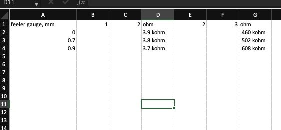

suprunner replied to suprunner's topic in 1990 to Present Legacy, Impreza, Outback, Forester, Baja, WRX&WrxSTI, SVXHi, Thank you for responding and I apologize for not getting back. It's finals month right now at school. I do not have anything left over from the '96. So, I can't swap the ICM, Won't be able to swap the TPS either. I did just check Resistance with the TPS... I followed the above's instructions. I'm attaching the readings that I got. I wasn't sure which terminal was 1 or 3. I figured the center terminal was #2 though. I swapped out MAF for a rebuilt MAF that I had purchased years ago. No change. Still has a dead-spot/hesitation at start-up when I first touch the accelerator, and unbalanced feeling at 2000 rpm +/- 100 rpm all the time.

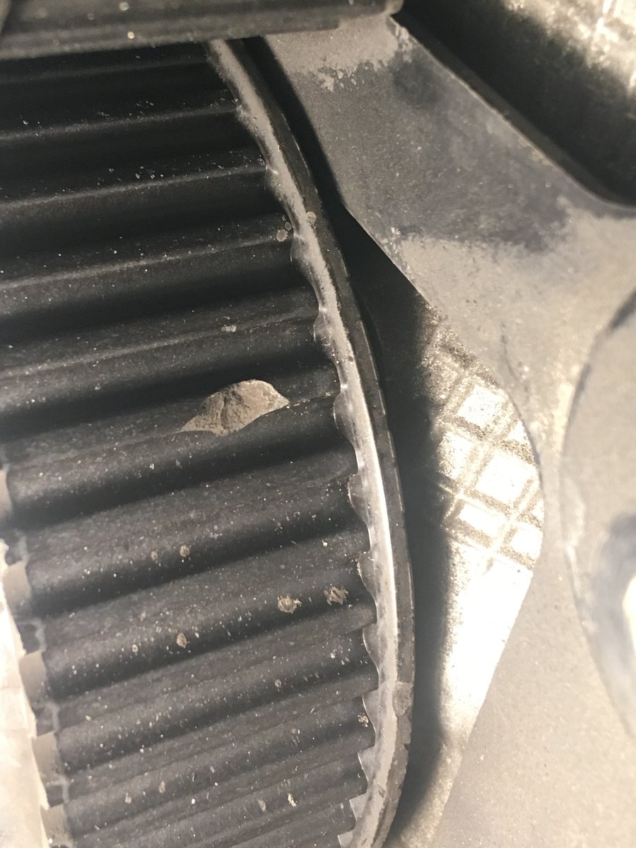

suprunner replied to suprunner's topic in 1990 to Present Legacy, Impreza, Outback, Forester, Baja, WRX&WrxSTI, SVXMight this have caused a belt slip? I guess I'll be looking for new cam gears. Cheapest I've found are $80 a pop.
Timing Cover Interchange?
suprunner replied to suprunner's topic in 1990 to Present Legacy, Impreza, Outback, Forester, Baja, WRX&WrxSTI, SVXRick, my English was poorly worded. The heads had been refurbished by the subaru shop. The cam gears were purchased alongside them. I can't attest to their actual ages, as I believe they were used inventory. Is there no visual inspection that can be done to see if there is the beginnings of failure? Or is it an all-or-nothing fail? Greg
suprunner replied to suprunner's topic in 1990 to Present Legacy, Impreza, Outback, Forester, Baja, WRX&WrxSTI, SVXThank you all for the input. I will only be purchasing a tensioner and belt. These cam gears appear to be in good shape. I picked them up from a subaru specialty shop in Boulder, CO when I bought my heads from them. They were refurbished. Is there a setup process for the tensioner? I'd been told that I'm to remove the pin, then compress the piston, and replace the pin. . . all before installation. I had not utilized this technique when installing the gates tensioner. Take care, Greg
