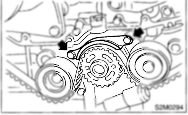

AEIOU replied to AEIOU's topic in 1990 to Present Legacy, Impreza, Outback, Forester, Baja, WRX&WrxSTI, SVXWOOHOOO! Got it! found one locally at the subaru heaven junkyard and now my car runs great for the first time in almost 2 months!

so as far as we can tell, the reason my car is still running bad is the crankshaft gear that we repaired isn't working right. It lost a tooth somehow that communicates with the crankshaft position sensor. The guy that repaired it did an awesome job, but I think that its still not getting a good reading on the sensor maybe because of the difference in conductivity between aluminum and whatever the rest of the gear is. basically, what we have determined is that cylinders 1&2 aren't doing anything. crankshaft position sensor code is on (already replaced sensor). I want replace that gear, now, but I can't, for the life of me, find what its even called to find one. I think I can get one just at a junkyard (if worst comes to worst I live about an hour away from subaru heaven). Anyone know exactly what its called? its the middle gear in the attached picture. Thanks!
