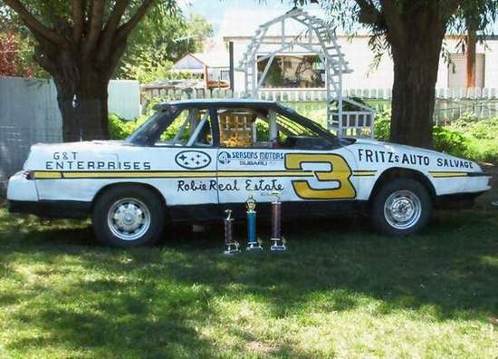

  3. Here you go subyrally. Need to update picture as we have more trophies now! I would rally mine if we had any of those events around here. A real blast to drive. Another bit of advice, use super heavy duty water hoses to keep that cooling system from failing. We also run a electric fan. Good Luck & have fun!! Oh yeah, we sipe & groove our tires. Makes a big difference in the dirt.
