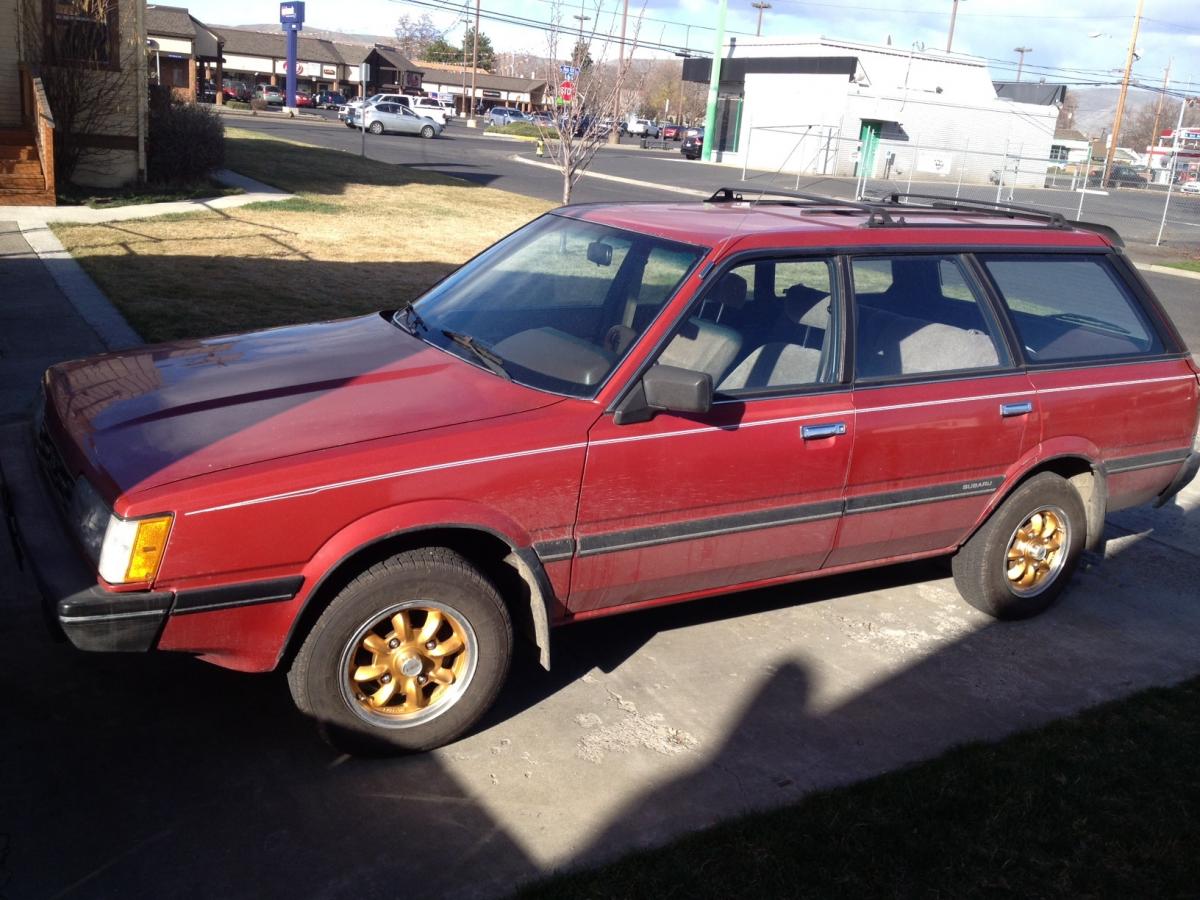

  9. Here is a recent pic of my 85' GL. Love this car.
  10. I keep it simple/stock.

  14. Thanks. Check out the new summer look. She hasn't had a bath for months...still sexy ;-). Thanks to SuperBrat for the swank Enkeis. My wagon is carbureted, so I may try it, but with a junk yard unit so I can switch back to stock if the move backfires.
