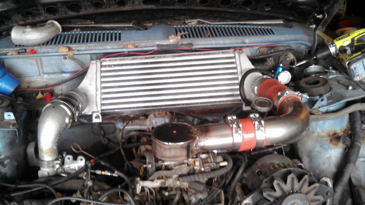

  3. Took the turbo subie down the road a couple of weeks ago. Have been messing with jet sizes on the carb and wanted to see how it ran. It was making 7 psi of boost! But still not enough fuel. It quit pulling around the pressure like there wasnt anything else to burn. Goin to have to get so more fuel to it. Then on the trip back got pulled over in my driveway for not having plates on the back. Oh well.

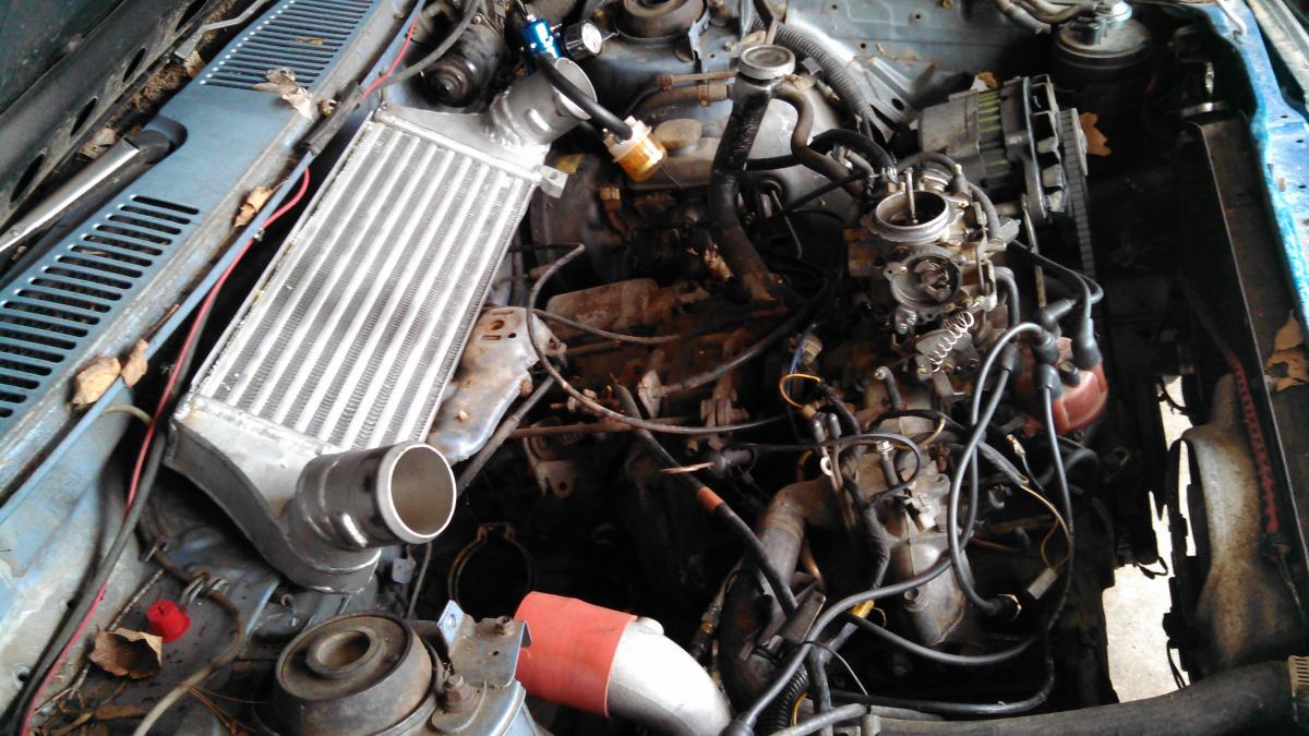

  5. Started it up, jumped in it, ran down the road, turned around, pulled out, straightened it up, floored it and dumped the clutch. Made some boost and then nothing.... stalled. Had to restart it. I thought I had figured out, but apparently I am pushing way more boost than I thought.... Back to the drawing board...
