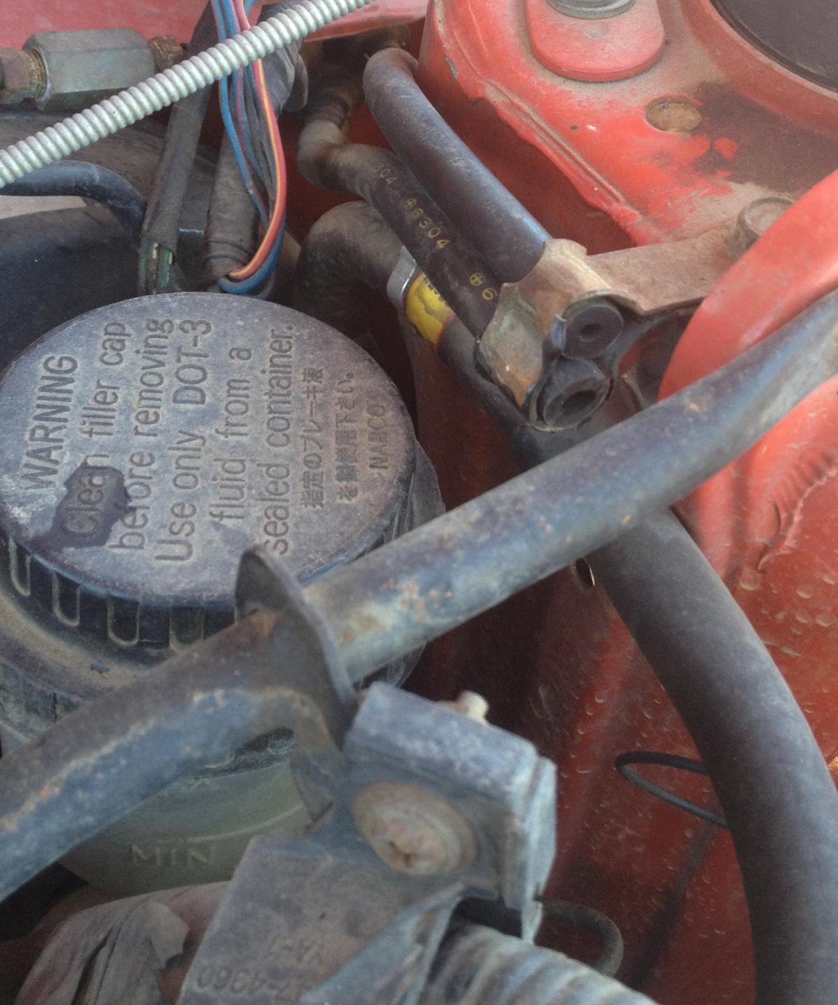

  1. I have read it over and over, and I know this much: I need to close the return line and leave the vent line open. I don't know this much: in my picture, which is the vent and which is the return?

  3. is the return the one with the smaller inside diameter? or is there a way to tell which? in the guide it says the vent is 1/4" and the return is 3/16", but doesn't mention whether or not they have different inside diameters? It looks to me that they have the same outside diameter, so I'm not sure which is vent and which is return. Nothing bad to come from plugging them both though? just definitely don't run them in line with eachother?
  4. i'm pretty sure they used to be the return/vent lines for the gas tank and the hitachih carb it had on it, but when he put the weber on he just cut them and left them hanging there. Maybe he missed that part of the swap guide. I read in the swap guide that i'm supposed to plug the return and leave the vent open, but I'm just a little hesitant to do anything wrong.
  5. Still could be fuel pressure too high though. The mechanic replaced the fuel pump when he installed the Weber but I'm not sure if he knew how low of a pressure was required. I assume so because he's a mechanic
  6. It is definitely a Loyale, and it was definitely carbureted stock. The fuel was not leaking out of the carburetor but out of the return and or ventilation lines coming from the tank as shown in the picture
