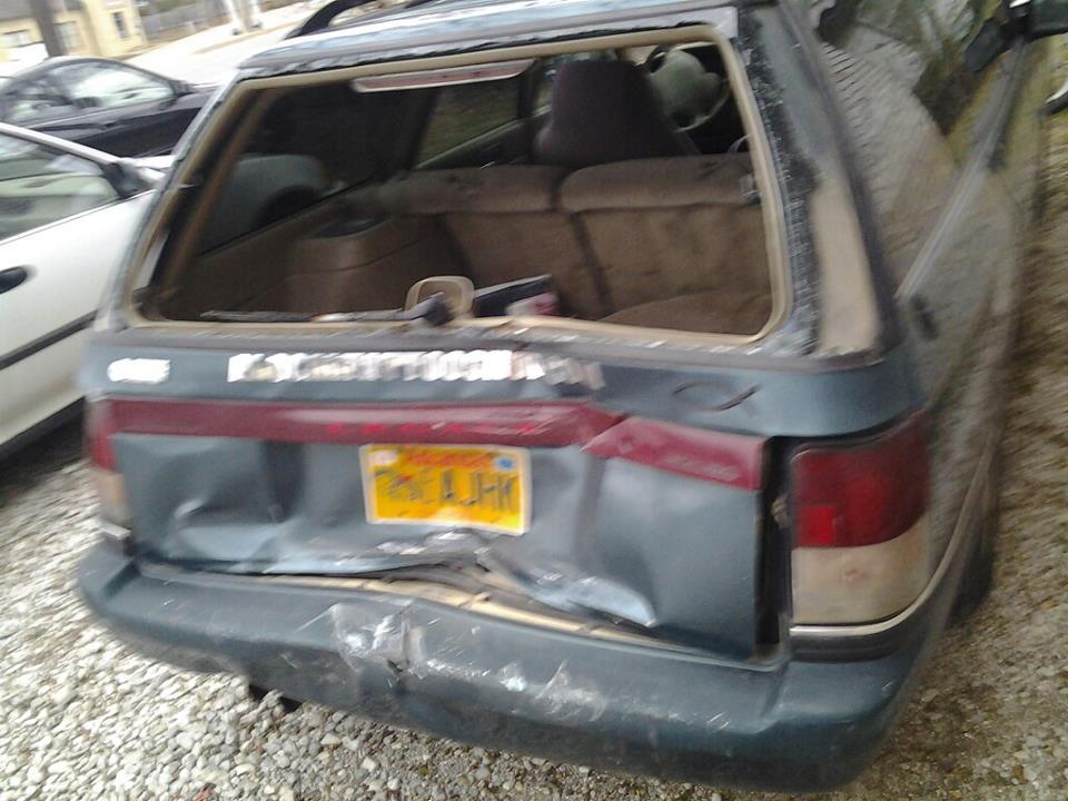

  21. Just checking in and saying hello before I start diving into old post. Driving, repairing and loving my 93 legacy wagon :0). Look forward to learning more here and hopefully contributing knowledge to others at some point. Picture of her as she started needing loved.
