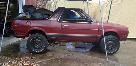

OK....Finally it rolls on the Impreza suspension!!!!!!!! I'm still not thru, rear will be 2.5" higher and the front will be about another inch higher. What you see here is with my '98 2.5RS Impreza 16" wheels on. The final 'look' will have 27" tires. These are only 25" in dia. DAMN once again can't download the pix it's too big and even my kids laugh at me when I ask how to reduce it. Any feedback would be appreciated. LOL. Gary- 2.2 swap senario
