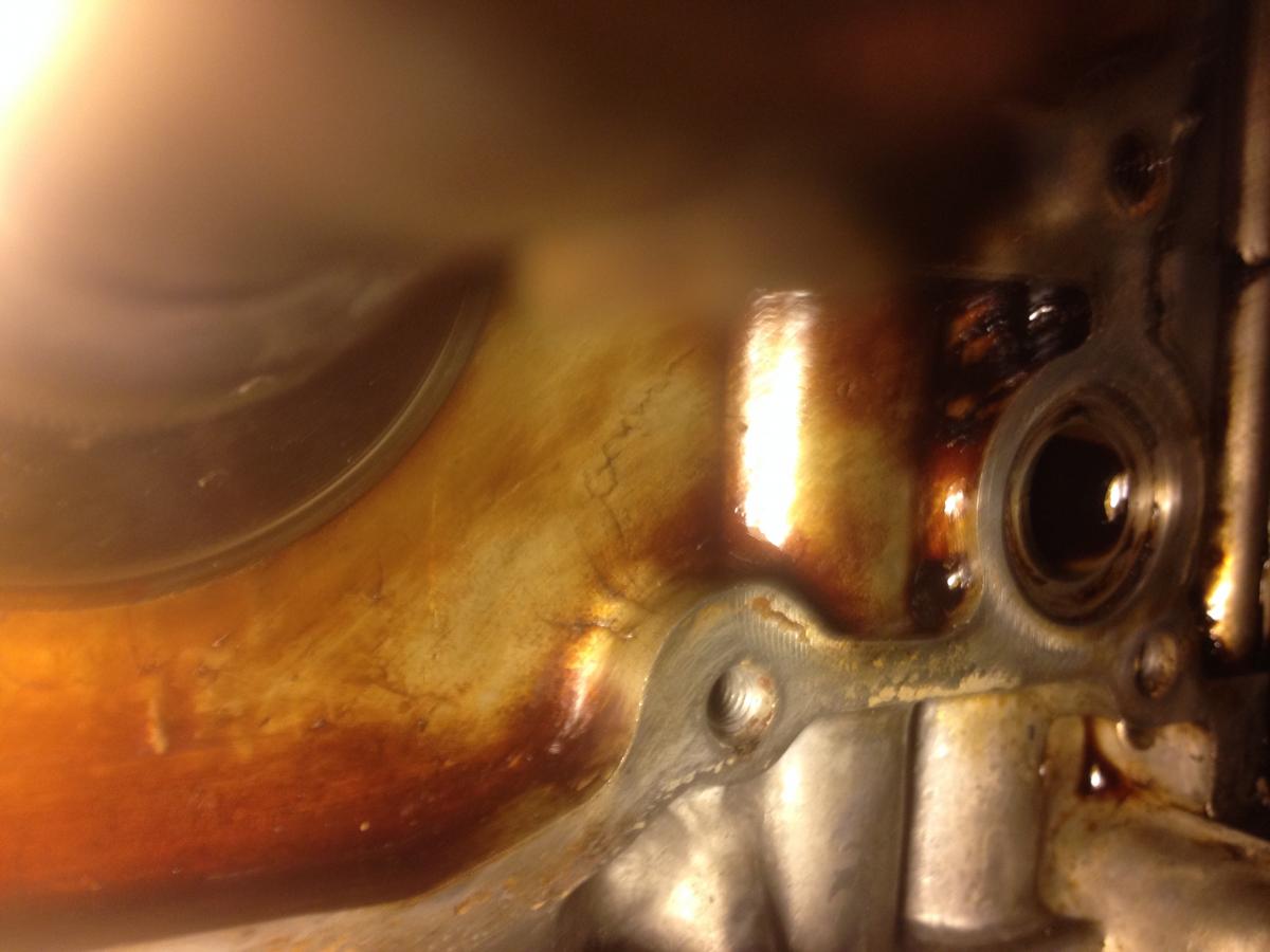

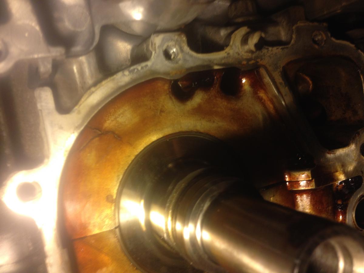

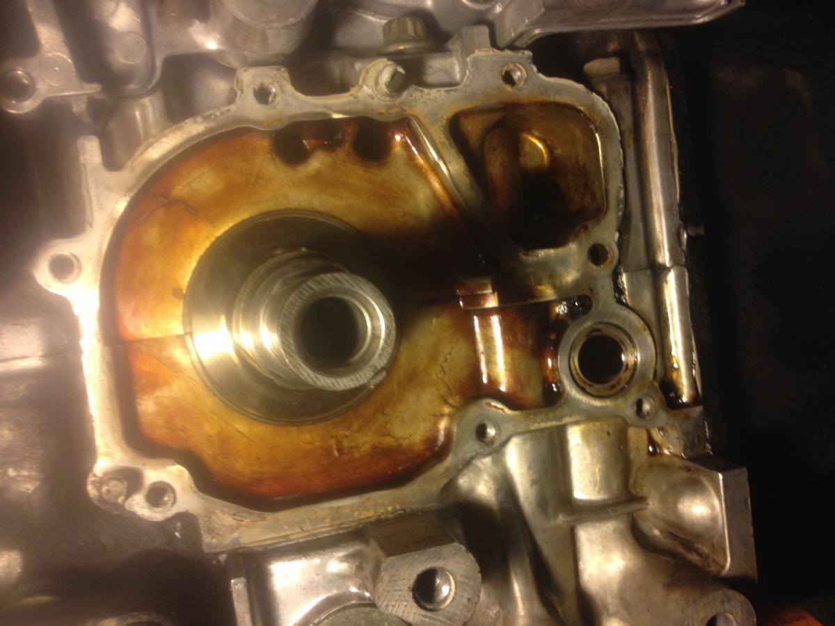

Cracked case behind oil pump
iriejedi replied to iriejedi's topic in 1990 to Present Legacy, Impreza, Outback, Forester, Baja, WRX&WrxSTI, SVXJust wanted to let everyone who paid attention know this car has been running great for a while. Not really sure if they had been casting flaws or stress cracks but I did tighten two of the three oil pump screws and lock tight them back down. Put everything together and ran with it. Should anyone be following the post the biggest take away I learned is to inspect the oil pump when you have this stuff all apart. I read one guy's post somewhere that 40% of the screws tend to loosen up on the oil pump. Made sense to me, now I'm going to always inspect oil pumps when doing a belt job. It was also easy to use the Ultra Gray silicone to seal everything back up with the new o-ring in place.
iriejedi replied to iriejedi's topic in 1990 to Present Legacy, Impreza, Outback, Forester, Baja, WRX&WrxSTI, SVXOkay, the pic just seemed like a deep crack especially with the aluminum chip coming off of it. Power washed the engine, this is the only place I saw that type what looked like a stress crack. Thanks guys!
Has anyone seen a case crack only behind the oil pump? Should I scrap the engine and find another donor? It has 125,000 miles but I do not know any other history other than many oil leaks before tearing down to try and reseal engine.
