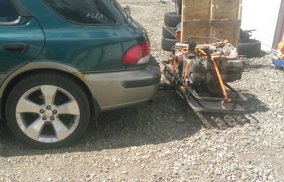

I thought I was going to go and do the ez swap and then a really great deal came up for the eg33. I got one with 89k on it. It's been setting for around 14 yrs. Got it to run on starting fluid for a little while. The only thing I'm lacking for the swap is the exhaust. Not having a truck it was an interesting trip only having a hitch haul.
