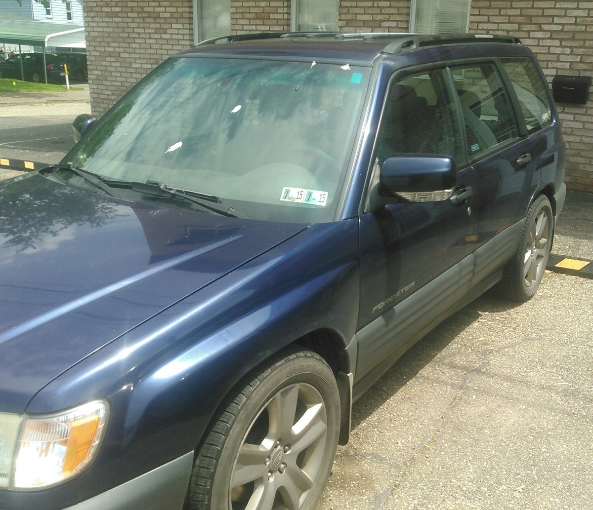

  1. I just picked up a steering rack out of a 05 legacy gt it has the 15.1 ratio like the sti. Anybody use one in anything other than a legacy? The valve looks considerably different than the old Forester rack I have. Do I need to use the front subframe also from the legacy for it to work in a 02 Forester? Thanks
  2. Wasn't that lucky for it to be plug and play but I have the fsm for the 02 and got the wiring schematic off a Forester forum for the 05 and made a jumper harness going between the two. Luckily I had gotten the gusset also with the mirror being as its different. The mirrors have different mounting points. Not one of the holes lined up. The gussets have four mounting points three on the top and one on the bottom. The three on top lined up pretty well. The bottom one didn't. I left the bottom one out since the mirror felt stable enough with just the three. I hope this helps.
  3. Just got them all wired up today. That was a little easier than I expected. It's one of the better mods I've done to the car.
  4. Any thoughts? Has anyone else done it? They're sort of on there not wired up just mounted on the car. I think that they look pretty sweet on there. Kind of a pain in the a** though.

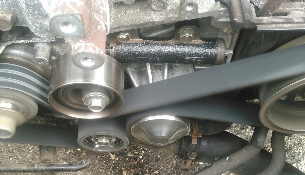

  9. Thanks for the info. I didn't want to put out any more cash if I have something that will work. Its a new Subaru tensioner was hoping it would work. Thanks
  10. I just picked up a 2002 forester with super low miles 45k and before I put it on the road I was going to change the timing belt, pulleys,water pump etc.. Well before I could change everything, I drove it around the block after I worked on the brakes and the engine started making a terrible noise. Sounded like it was coming out of the timing cover sure enough after getting it apart, started up without the cover on and it was the tensioner making the noise. My question is can I use one of the older style tensioners on the newer engine? I have a new tensioner and tensioner pulley with the bracket that was for my 96 impreza. Can I switch the bracket and use the older style? Thanks in advance
  11. Thanks for the replies. I was kind of figuring that they were interchangable that there would be slight differences. I wish I could hear it run first but for the price I can't complain.
