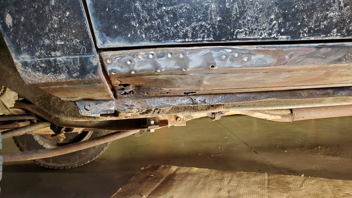

  1. Fooled around a little more last night and found another area that was covered up by a previous repair. The front fender was replaced at some point due to an accident. Looks like they just tried to pull some of the smashed area out then covered it with bondo. Some had fallen out, it was about a 1/4 inch thick.

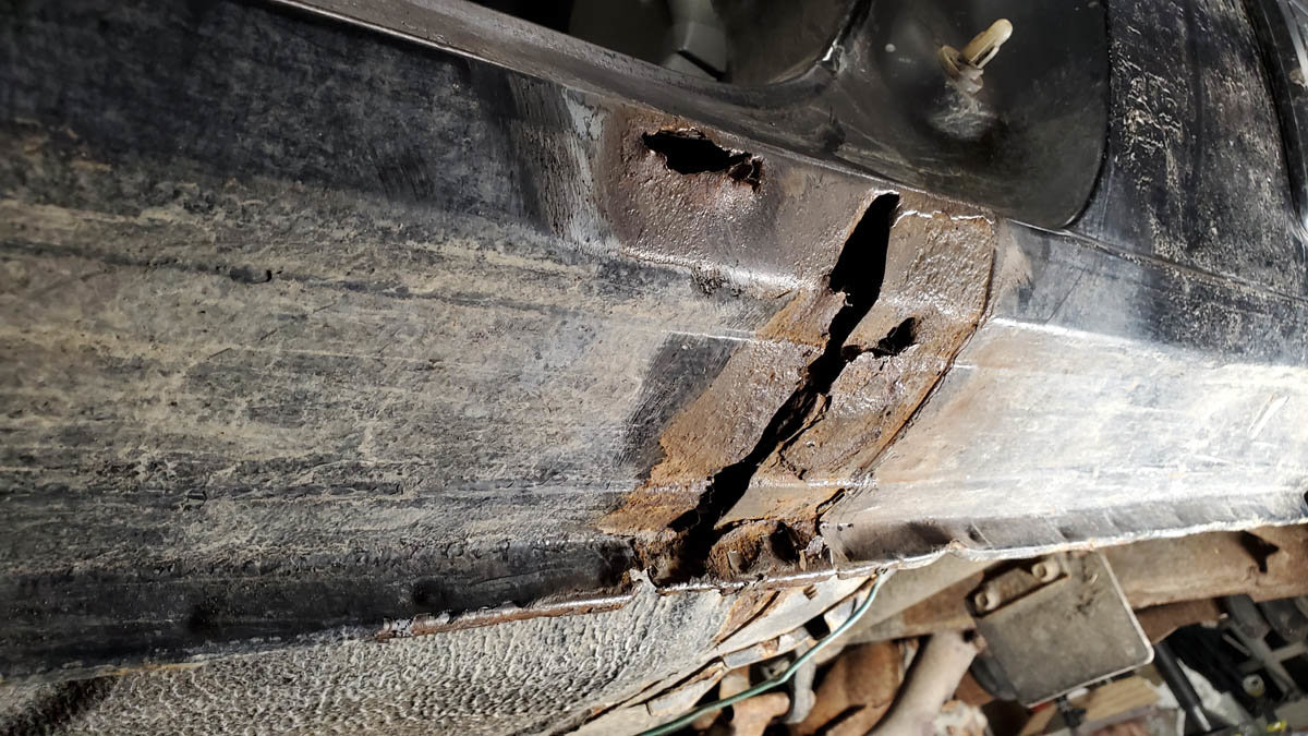

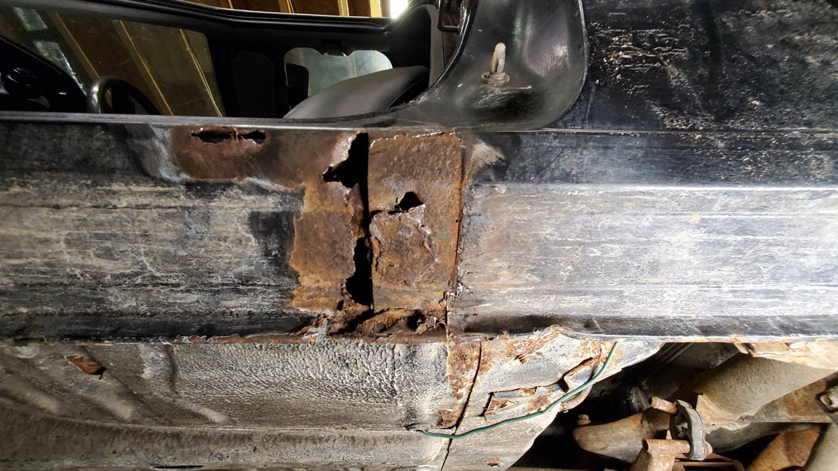

  3. I agree, metal would be preferred as to strength, and this is in an important location. I would guess finding a good rocker panel would be near to impossible, so fabricating will be the only option. I've got some 16 gauge cold rolled, but it's really stiff and hard to work with. What is a good sheet steel to use?
  4. That's always the issue on a fix like this. I can prep the area inside and out with some rust remover/preventative then do a patch that does not require heat (fiberglass or some type of panel bonding) and call it good. The issue with welding a patch on is that once done there is not a way to recoat to mitigate a continuation of rust caused by heat during welding since there's no way to get back in there. It's a boxed in area. Do you know of anyway to do that?
  5. I'm finally digging into my 82 Brat to get some of these rust issues repaired. Thought I'd tackle the worst one first. This is on the drivers side below the back of the drivers door. Looks like where the back section of the body was welded to the front section. Seems to be an overlap and a great place for rust to form. There's a similar place on the passenger side, but not quite as bad. Do I need to repair this as a structural fix or just cover it up and paint over it? There are a couple of other smaller rust through spots on the rockers, but they are mainly small and I'll probably fiberglass those.

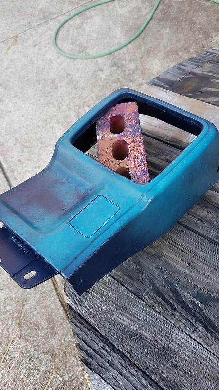

  10. I just finished reworking mine in my 82 Brat. PO had poorly installed a Radio Shack cassette deck and equalizer along with running screws through the shift console to hold the shift boot. Somewhere along the way they decided that it should be spray painted black. Not sure what kind of paint it was but it didn't stick very well to the plastic so it was looking pretty shabby. The good part is that a couple shots of carb cleaner caused the paint to wrinkle and could be easily scrapped off. I pulled the radio and equalizer out and remounted them with some better bracing. They were great vintage looking units and both amazingly worked really well. There are some scrapes on the plastic, but overall all looks pretty good after the black paint came off. I pulled a shift console out of my parts car. It was a faded looking blue. I picked up a spay can of the Dupicolor vinyl paint in dark grey. Not really dark as some of the other plastic parts, but close enough and looks better than the one with the screw holes. Also sprayed the vinyl boot, which was blue. Not sure how it will hold up, but figure if it doesn't I can make a new one using it as a pattern.

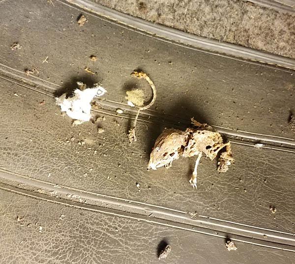

  14. Rats were literally in my Brat... fell out when I removed the driver side defroster duct.

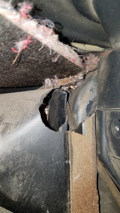

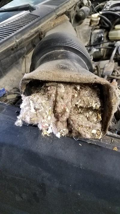

  15. finally got into the rat problem. Found a huge nest that was clogging up the duct from the blower. I don't think there is a nest blocking flaps keeping the lever from moving. Looks like the lower flap is stuck, and really stiff. Needs a little exercise and maybe a squirt of lube. Why do they have to cut their own hole?
