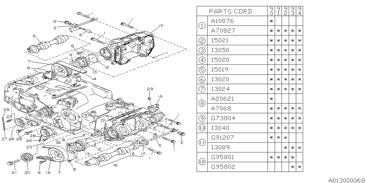

  3. Yes when I initially looked at the diagram I thought it was the heads, but when I magnified the image realized it was the cam and housing assembly instead so looking at the picture in the service manual, I had a lightbulb moment. Haha. I did order the oem o-rings and got a couple extras given the increasing scarcity of parts. Now it's just a matter of waiting on them to get here. I did clean out the reservoir and refilled with fresh coolant to attempt to verify the condition. You are correct that these tend to collect alot of junk in the tank no matter what. My concern came from the fact that even though it has floating junk, when I poured the contents into a clear bottle it left a film on the bottle at the top, and it smells like burnt motor oil instead of the usual sweet antifreeze scent along with being somewhat murky instead of light green.
  4. I see what you are saying now. The o-ring you reference is on the camshaft housing assembly, which attaches to the other side of the head. The picture in the service manual its easier to see than in the diagram.

  6. Where exactly is the cam tower to head joint? Looking at the diagram, it is showing the part # given, which is #11 in the diagram, on the block side of the head where that copper portion of the head gasket would be positioned. Are you saying that the OEM type reinforced O-rings should still be used at that location? I've done about everything else on these motors except for head gaskets, so pardon my lack of firsthand knowledge on the specifics for it. I do want to make sure it is right the first time to avoid future problems. I appreciate all the input. I was always told when you stop learning something new, it's time to stop doing the job. This forum has a wealth of knowledge on these vehicles.

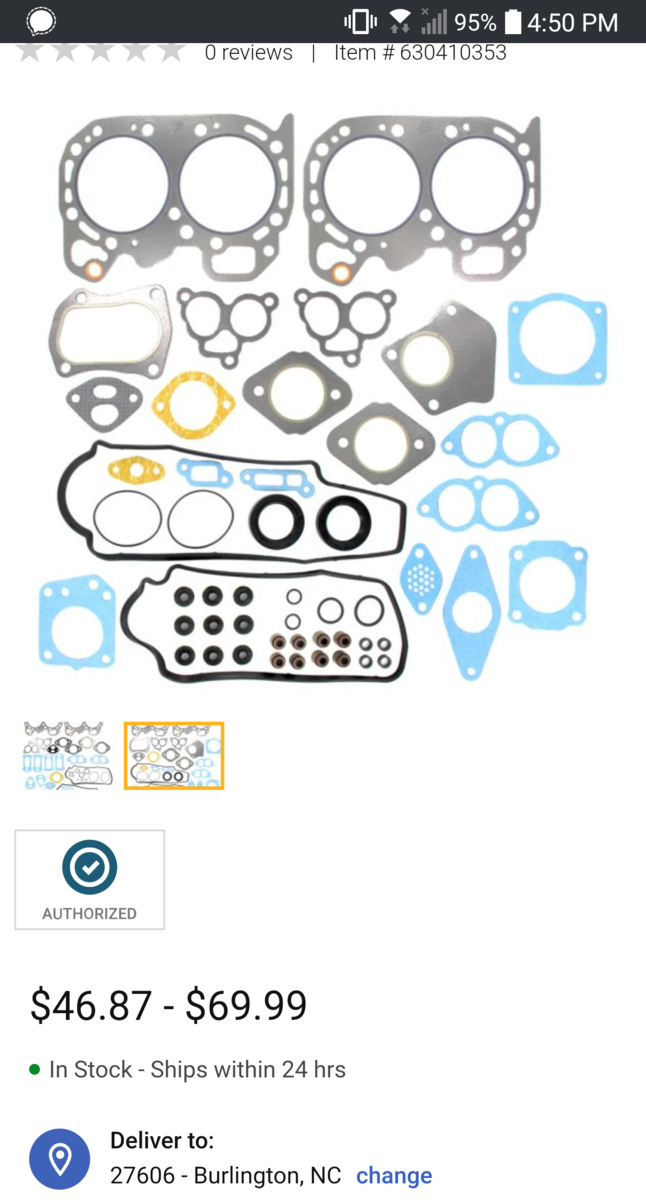

  7. Just throwing this out there, but looking at the head gasket they sent, it almost looks to me like the hole for the oil galley you guys mentioned where that oem type o-ring goes, the head gasket itself is either made of copper there or it has a special coating for that galley alone. It appears orange/copper colored (bottom left in the pic). Am I correct about that, or looking at the diagram wrong? Perhaps they made it that way to relieve this issue with the rubber o-rings? It is #11 in the OEM diagram. And I believe the intake gaskets in this kit are stamped metal with a coating from what I can tell. Made of the same material as the exhaust gaskets on the head.
  8. It seems pretty decent. The head gaskets are graphite coated, along with valve seals, and the assorted metallic gaskets, cardboard/paper type gaskets, and O-rings.

  11. I just got the kit from APEX, but had already gotten some Victor Reinz seals and o-rings for the cam towers. Are you still able to get OEM for those? Do you happen to have the part #'s handy for them? I've invested alot of $ and wrench time into her. They are absolute tanks and extremely dependable. The age and corrosion are starting to catch up to her, and parts are getting harder to find.

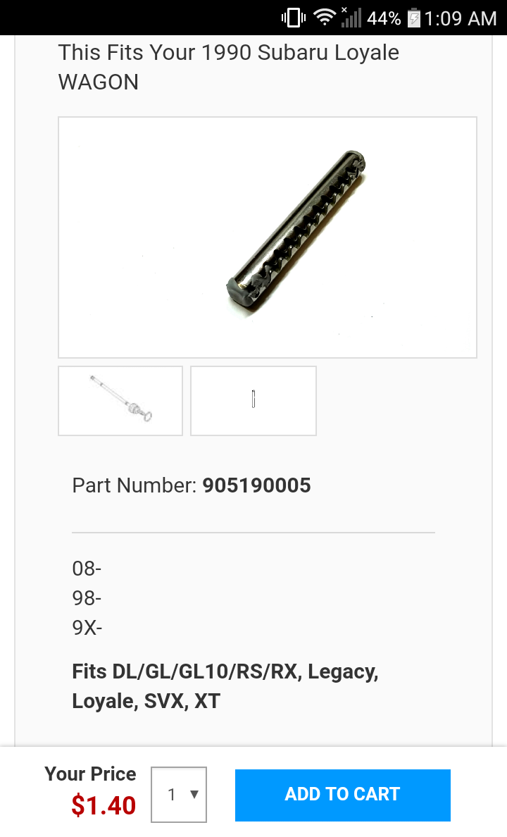

  17. Google search pulled up an oem site. Plugged in vehicle info and the correct part popped up. Since they are still available, I went ahead and ordered a few to have myself. It's the smallest things that are hard to find for these gems.
  18. Here is the OEM part # in case you have any issues or prefer to stick with original parts.
  19. That should work perfectly. The roll pins are the same on multiple models. I may have to get a few of those to have around myself. Lol.
  20. I have a set of generic clip hardware I got from autozone(has clevis pins, snap rings, roll pins, etc.) and the larger roll pin is perfect for these axles. I destroyed mine getting it out last time and replaced it with no problem. I will try and get you the info on the assortment as soon as I step out to my shop.
