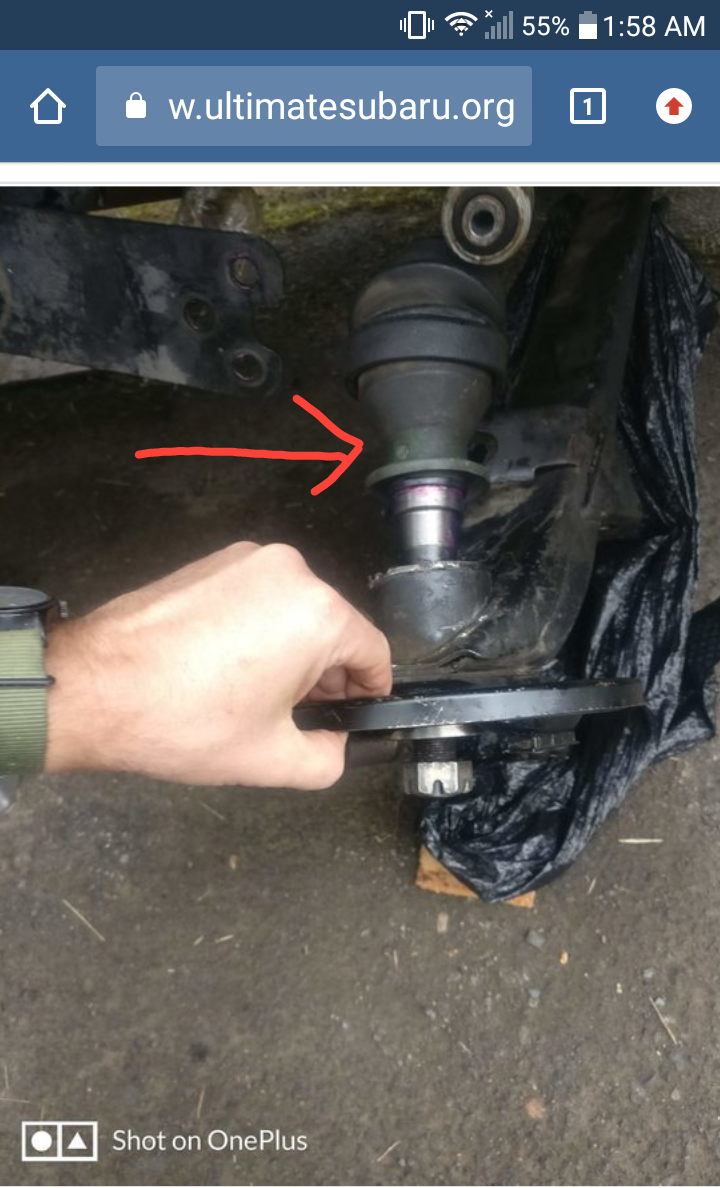

  9. So I am not sure exactly what vehicle this is on as it doesn't state, but if this is an older gen 4wd like my loyale, the axle shaft is splined on the back side and connects to the cv axle via rollpin. Looking at your pictures, im guessing the bearing has been pressed into the hub but the axle wasn't pressed into the bearing. I've replaced both of my rears, and always press the bearing onto the shaft. Then I put the shaft/bearing assembly into the hub (typically you can tap it with a rubber mallet and the entire bearing/shaft assembly will go in fairly easily.) Tighten the locknut with inner seal down on the back, snug the spindle nut finger tight, return the hub assembly into the vehicle, and once everything is back together and the vehicle is lowered, torque the spindle nut to spec. I'm sure you could try hammering the axle into the bearing as you stated, but you run the risk of damaging the new bearing with the force needed to press the bearing onto the axle.
