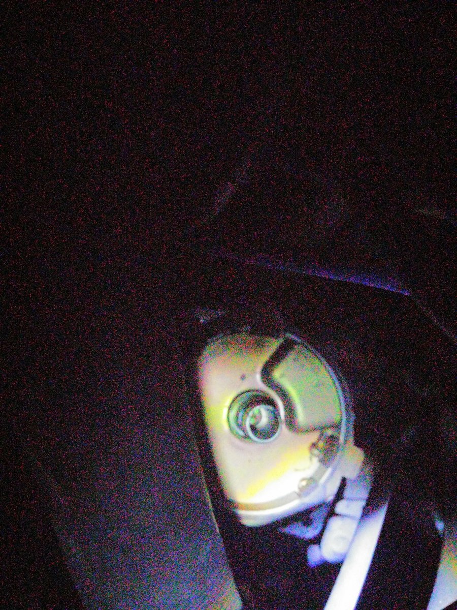

So I went to the car. I was alone so testing spark was not really practical. I popped off the distributor cap and what I found is in the attached photo. A few hang ups with a dropped screw but got it together and drove it home! Kind of a weird design because that screw is kind of difficult to get tight. I did notice that even with the screw tight that there was a little rotational play in the rotor when I turn it by hand. Should it be like that? Seriously, thanks so much. Thanks! kmpdx
Battery is clean but its overall integrity is not the best. I really hope it is the rotor and not the timing belt...Just cause here I am living in apartments and I am limited in things like draining radiator. I have actually replaced timing belts and rotor relatively recently. I don't think I put loc-tite when I did the disty-rotor. My fingers are crossed that is my problem
