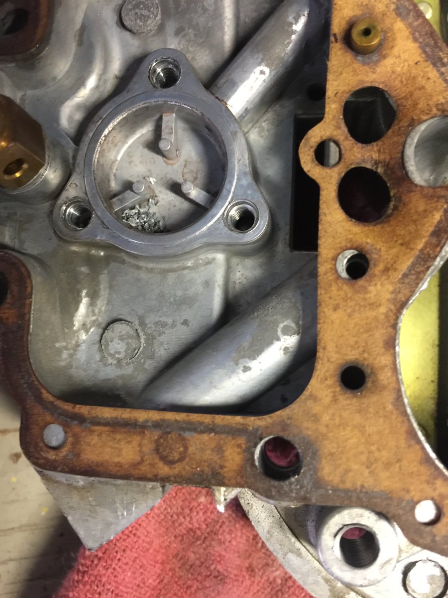

Figured out why my Weber was dripping fuel - special bonus inside
So my practically brand new Weber 32/36 (ok, it's about a year old) started dumping fuel down the primary side. The intarwebs told me to check the power valve. When it took the valve off, I discovered a special extra bonus included in the purchase price of the carb - metal shavings! When I blew some air back through the vacuum passage with an air gun, sure enough, one more little fella flew out. Flooding problem solved. So I guess now we have to disassemble our brand-new carbs before we install them.

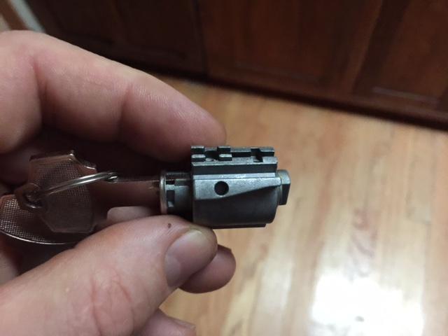

Anybody replaced a lock cylinder on a circa '85 Brat?
Closing out this thread. I did not take the whole lock off because it would have required pulling the steering column. Incidentally this is on an ' 85 brat with tilt column. So I ended up drilling out what looks like a tiny little plug on the back (dash) side of the lock. It looks like it's really not a plug but a pin that is pressed through the hole. The pin is all that is holding the cylinder in. My cylinder came out with another couple of pieces (the steering column lock actuator) that were a pain to reinstall, but essentially reassembly just involves shoving all that stuff back in there. Instead of the pin, I used a self tapping screw to hold the cylinder in. On to the next project.
I like that answer a lot better, thanks! Although I don't think my drilling was anything like perfect, so that may be a problem. Just so we are on the same page, is the little pin that I drilled out (well, more like drilled near) actually holding the cylinder in? Or is drilling out the pin just giving me access to something else inside there? And if it's the latter, am I using the magnet to pull out the cylinder, or am I using to pull out the thing that I'm accessing via the hole that I drilled? And do I need to be worried about the key?
I need to remove my lock cylinder and I'd really rather not unbolt the whole ignition lock. I'm guessing there's a magic trick to do this, but I haven't been able to find anything online. Has anybody actually done this who will tell me the super secret trick? I have the key, so that's not an issue. I did find a little plugged up hole on the dash/under side of the lock that I drilled out, but poking something into the hole didn't release the cylinder at any key position. Pic attached: it's the underside of the replacement lock cylinder. The hole in the cylinder is approximately in the location where I drilled out the plug. Am I just not pushing hard enough through the little hole I drilled?
