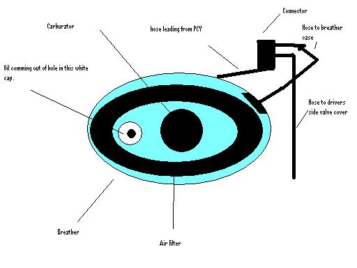

  9. Only thing is , It doesn't look like the oil is comming out of the pcv valve tube, Unless I am missing something. The oil is comming out of the little hole that is located on top of a little white plastic cap to the left of the inside of the air filter case. I made a diagram in paint .... best I could do while at work :-)

  16. Ran some lucas through it today. I'll run it and see how that does. After some miles, I'll do an oil change and run a can of restore through it and see what happens. I've never used Lucas before today but a few guys on the high powered motorcycle drag circuit sware by the stuff. It's almost like glue going down. Thanks for the info.
