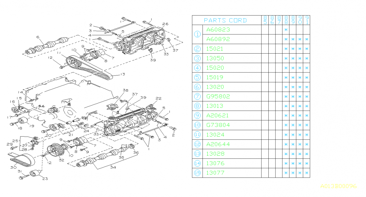

I don't see any toothed idler pulleys on this Subaru diagram. Maybe their are none, just the two tensioners i have, the two nowhere to be found smooth Idler pulleys and the two big toothed cam sprockets. Apparently Subaru shows no love for the sweet old 2.7 H-6 :/ -

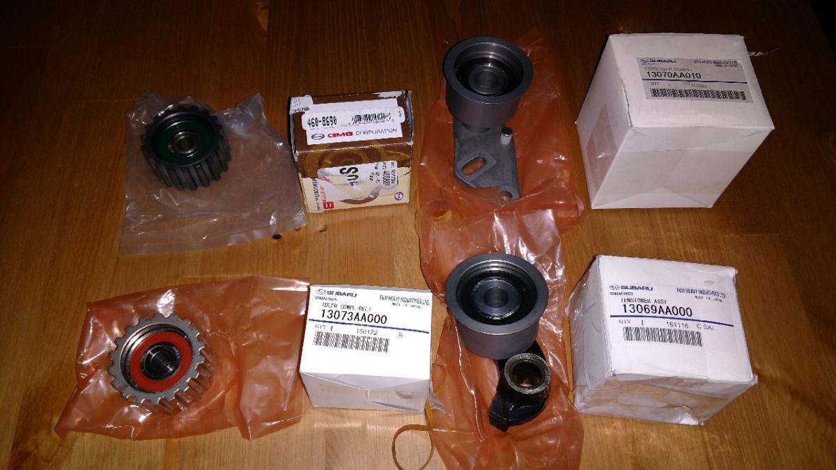

The GMB toothed pulley is the same as the Subaru toothed pulley 13073AA000. This is the upper toothed pulley according to GMB. -

The toothed pulley from Subaru is 13073AA000. They call it IDLER COMPLETE-BELT. If you can get to a Subaru parts website, http://parts.ramseysubaru.net, they link this part number to #19 on their diagram, which looks like a smooth idler pulley to me. The other toothed I have is aftermarket, GMB Timing belt idler 460-8690. Both have bearings with "6203" on them and look similar. The GMB part is an upper idler, not sure about the Subaru piece, maybe the same. You gave me these: Subaru timing idler pulley part numbers: 13073AA020 13073AA040 Both are no longer available The website links to the same part as the sprocket, so another Subaru mistake -

	Attention Subaru Gurus! Will these tensioners and idlers do the trick? I ordered Beck Arnley belts from CRock Auto, they sent 1 Beck Arnley belt and 1 Subaru OE belt that felt like an old dried up rubber band. Got a refund and ordered 2 Dayco and 2 Gates belts from trusted companies, to compare and choose the best. Any opinions? Here is what I have for tensioners and idlers: Subaru OE Tensioner 13070AA010 Passenger side Subaru OE Tensioner 13069AA000 Driver side Subaru OE Idler 13073AA000 Lower GMB Idler 460-8690 Upper Can I reuse the spring on the Passenger side tensioner? I'm resealing the whole engine, everything you experts have suggested thousands of times before. Rewiring the CTS with a new fuel injector pigtail, reworking all grounds, tweaking the tiny ignition switch screw (poor engineering) and connector under the dash, etc. I know this dead smelly horse is haunting you by now but you will satisfied to know I am not chopping this XT6 up, it will remain stock right down to the little 14" salad cutter wheels. Any suggestions are appreciated.

Here's what I see on the Ramsey NJ Subaru site: Right side tensioner, #16 on the diagram, part# 13070AA010 Left side tensioner, #21 on the diagram, part# 13069AA000 Idler assembly, #23 on the diagram (lower idler?), part # 13073AA000, your part# 13073AA040 shows as NLA (no longer available). The second idler assembly, #19 on the diagram (upper idler?), I guess this is the tricky one. I do see an aftermarket option, GMB, part # W0133-1631014 What do you think? -
