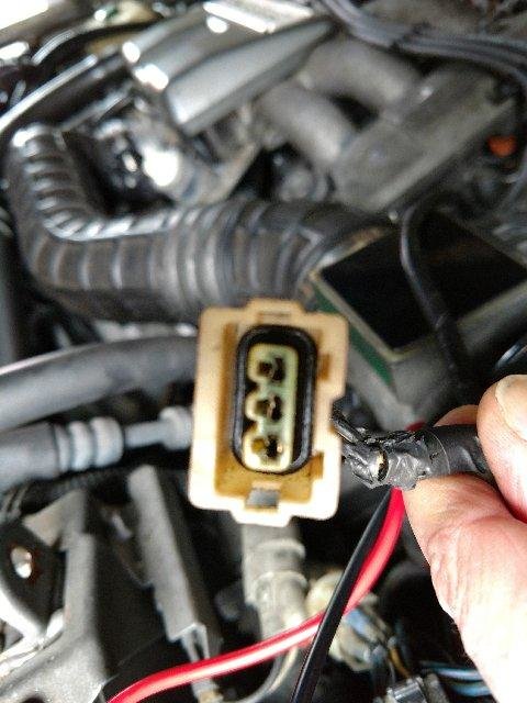

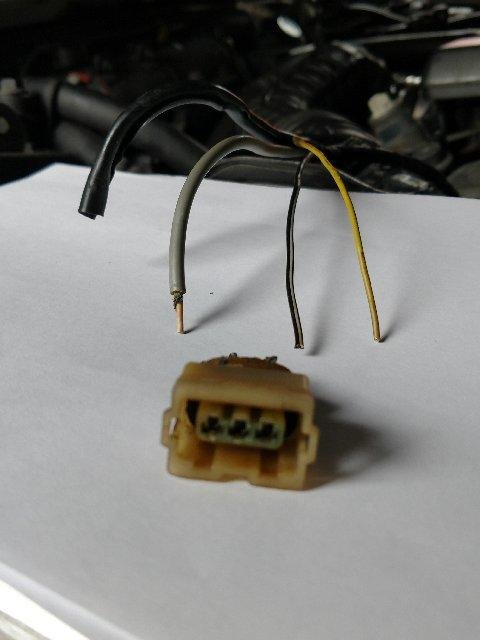

Lol, I'd have to learn Morse Code to read the trouble codes. I have original repair manuals but I don't want to fiddle with the main harness at the ECU yet. The IACV pigtail is definitely part of the problem, 12.2V at pin 2, but no voltage or OHM readings on pins 1 or 3. I didn't check voltage at the CTS pigtail when hot but will do. The CTS pigtail is new but I'll try to get 5V out of it. I'll check an auto parts or electrical supply store for new pin connectors for the IACV, they look unique but nothing I can't fix there. The plastic housing is also unique, hopefully I can find a suitable replacement or just reuse the original. A pinched hose is possible, the input hose is new but it's just a straight generic hose making a pretty tight turn, Subaru didn't have one. I'll keep this in mind when everything else is done. I'll clean the IACV good, with intake cleaner when I put everything together again. I should have results by next weekend, thanks for your help.

Thanks for the info, this is what I found this morning... Key on, 3.2v at the CTS pigtail, 3.2k ohms at the CTS. Starts up with normal idle, warms up and maintains 750 RPMs. After letting it get hot, the fan cycles and the engine stays at perfect temperature. Now I see 0.23k ohms at the CTS when it's hot. I notice a hum coming from the IACV with the key on, engine not started. I disconnected the pigtail at the IACV and gave it a hot restart. The idle goes up to 1,250 RPMs when in park, down to 750 RPMs in gear, but it runs rough with the check engine light on, can this be a vacuum leak? I noticed that the IACV pigtail is a bit of a mess, I'm going to order a new one along with a new CTS and see what happens after cleaning the IACV again. Would a little bit of WD40 help the IACV work better? If this doesn't work, I'll have to splurge for a new IACV. Rockauto, or Subaru? I know the harnesses on these cars cause problems, I have solder sleeves and tape ready to go. I found a few testing procedures to follow. Any more advise is appreciated.

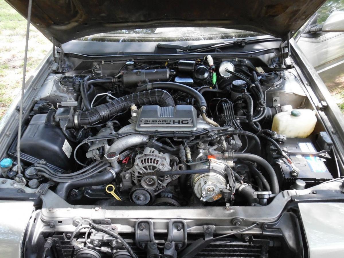

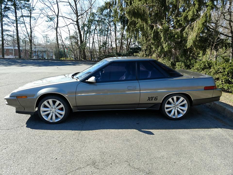

It's been a while since I posted anything. I recently did a complete reseal on my 1989 XT6, 2.7L H6. Look it up if you are doing the same, lots of good advice from members, with part numbers, pictures and some highly expected HLA issues. Everything is great, no clatter, no leaks, no smoke, no problems! All I need to do is recharge the updated R13 ac unit for the hot summer I'm predicting. I put a brand new set of 17" wheels from a 2012 Forester, 5x100, +48 ($400 for all 4, shipped) with Riken summer tires, 215 40s ($200 for all 4, shipped). Perfect fittment, highly recommended size combo. The ride is fine, no real difference from the original wheels and all seasons, probably because the front struts are original Subaru! The Forester wheels are heavier of course, so the car actually feels more stable and planted. Don't worry Subaru purists, the original salad cutter alloys are tucked away in the garage...

Good to go! The reseal of my 1989 XT6 2.7L H6 is complete and Slater is running strong, with zero leaks. like a scorched cat off the line the tires chirp and spin. The auto tranny hits second gear hard, I might be able to get second gear to chirp if I hit it right. the throttle linkage is sorted out to where it should be. Timing is advanced just a bit above baseline, it idles around 800 rpm. Sunoco 93 is the best fuel for this engine. The ac system is good now. After changing out the o rings and recharging, it turns on and the ac cooling fan turns on with it. It was defaulted by the ecu to turn on with the main cooling fan when the ac compressor wasn't working. Thanks again for all the help. I have a couple of months before salted roads force Slater into the garage. With temperatures in the mid seventies today, who knows when hibernation time arrives!

I'll check everything you guys suggest, but here is a big clue for you... When idling in park, it's at about 750 RPM, should be higher. When I put it into any gear... no change, still around 750 RPM. Timing retarded? I changed the CTS connector with a quality aftermarket fuel injector pigtail and the IAC worked fine before, didn't clean it though. A vacuum leak is also a possibility. The mechanic didn't put the AC back correctly, the clutch doesn't turn on, maybe he never recharged it. Also, the AC cooling fan cycles along with the passenger side fan. They should be independent of each other. So, we have a possible vacuum, timing or electrical issue I guess, Jeebus only knows what they may have messed up, but its not rocket science, I'll bring the car back to them next week. It's like most contractor work, you have them in your house for months and towards the end of the project, your at each others throats and the final details get screwed up. I'll post more as soon as we figure things out, probably won't drive the car too much, don't want to stress anything.

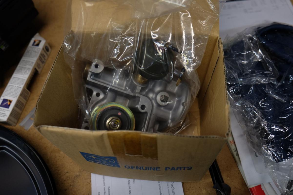

Success! The NOS Subaru oil pump did the trick. The original pump still showed decent pressure, however, new is new and it definitely is the cure for TOD. We had the cam case and head apart and installed a new head gasket, cam case o rings and HLAs. Not to mention, I lost count of how many cans of brake cleaner we used and following the service manual, word for word. As expected, the HLAs ticked for a while at first, but I was fed up, so I got behind the wheel and took Slater for a drive, a spirited drive on the highway. Within minutes things got quiet, to the point where it should The 2.7 sounds like it should, like a whispering old typewriter. I should fill the gas tank with Sunoco 93 and drive it every day and I have to go over everything under the hood, there are most likely a few bolts missing here and there! Thanks to idosubaru and other long time members here, for sharing your knowledge. This little coupe will be around for quite a while, making it one of very few left in original condition. Next Spring I may have some touch ups done on the body. Other than the easily replaced thin strip of metal under the rear bumper, there is no rust to speak of, I will park it at the first sign of salt on these Northeast roads. To the moderators that may have followed this thread, it may be a good idea to pin this little adventure.
Timing belt pulleys, tensioners, etc.
NOS OEM oil pump on its way. Still not 100% sure it's the actual one I need, until it's in my hands. One way to know for sure is to match up the mickey mouse gasket, since the 1.8L is different. We will see soon enough. From what I can tell, it's the 1.8L oil pump that is no longer available. The mechanic will replace the o ring, gasket and the pickup! Fingers crossed. This parts dealer can be found on eBay, as Northcoastsubaru, out of Glen Cove, NY. They claim to be able to get many old and rare Subaru parts, from Japan if need be.

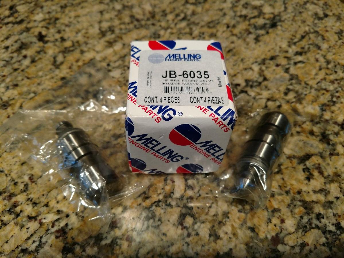

While waiting for the HLAs to arrive, I'm trying to wrap my brain around why only the passenger side HLAs are complaining I have a few common sense (rookie) questions... - If the clacking HLAs are on the passenger side only and the driver side is perfectly quiet, can I assume that the oil pump is fine? We primed the pump before startup and tested oil pressure externally, getting normal readings at various temps. - Is it possible that during the reseal, with the engine on it's passenger side while changing the head gasket and such, the oil found its way out of the HLAs and they are not priming because they are tired and spongy? -The mickey mouse gasket was a bit tricky for the pros to install. Do each of the ports that the "ears" seal feed oil to separate sides, driver and passenger? If so, this may point to more air getting to the passenger side HLAs, which may very well be the issue since they all feel spongy and don't seem to want to prime themselves. Air in the system is all that makes sense to me right now. I plan on the usual recommended tasks, placing the HLAs in a bag filled with thin oil for a day, priming them by hand and idling between 1,500 and 2,000 rpm for as long as it takes to drink a Red Bull and say some prayers... 20 minutes or more. This 2.7 was very quiet before the reseal, once in a blue moon an HLA would clack for 2 seconds, then disappear into the usual sewing machine banter. If the clacking is still there after installing 6 new HLAs, 20-60 minutes of idling and/or a good long drive at 55 mph, I will most likely just take Slater home and see if daily driving with an occasional heavy foot can clear this up. -Would my next step be to check the new minkey mouse gasket?- Timing belt pulleys, tensioners, etc.
Still clacking on the passenger side after changing the suspect HLA. Mizpah needs my cores to rebuild, they have none available in stock. I ordered 6 brand new Mellings lifters from a reputable dealer in CA. We should have them by next Friday. Why are all of these XT parts concentrated on the west coast?- Timing belt pulleys, tensioners, etc.
