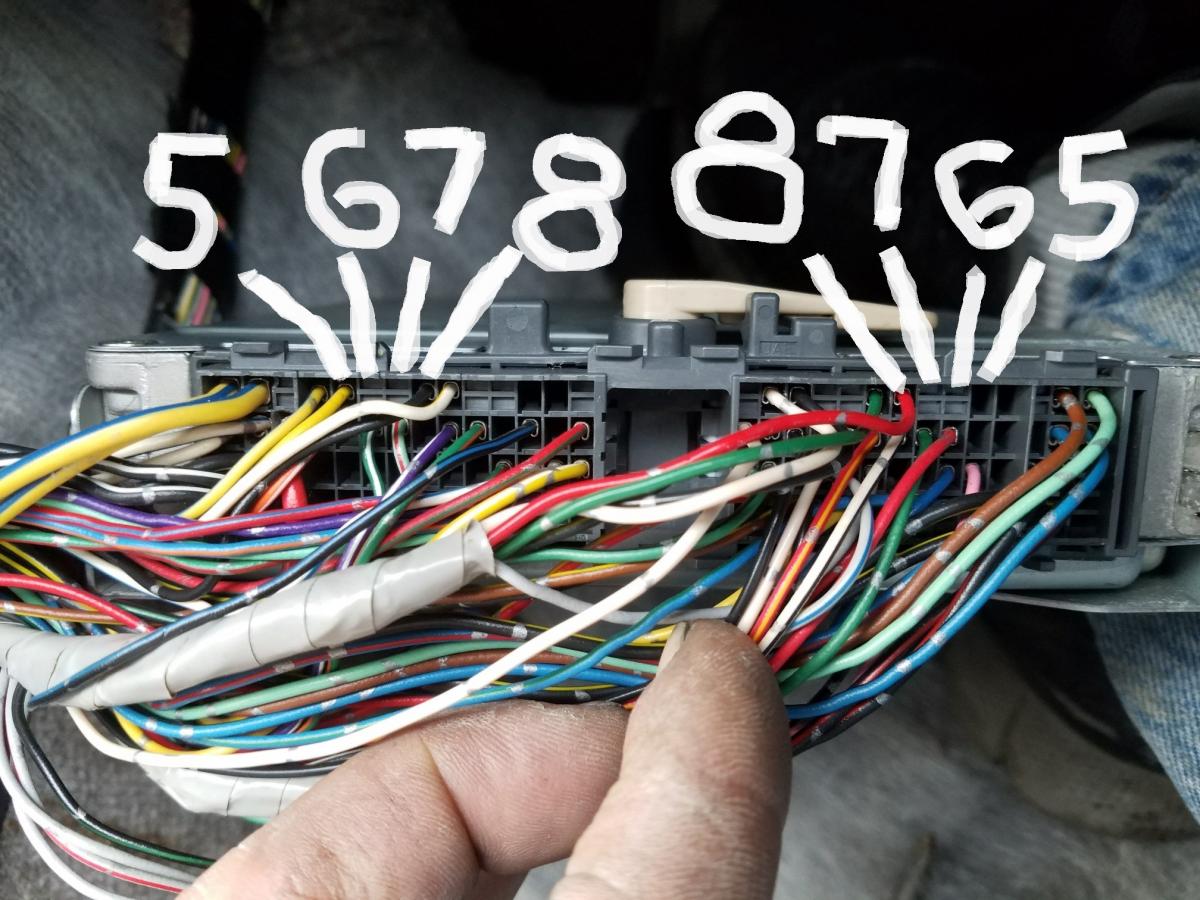

Sorry General but I MUST disagree here... If I DID that then the numbers 15 and 16 the large yellow wires would NOT be 15 and 16 they would then be wires 11 and 12 .... Because there's ONLY 12 wires in the top row of my ECM, but there are 16 ECU pins.... Right? Wrong? This is general knowledge I thought.... Gawd I'm starting to hate subarus

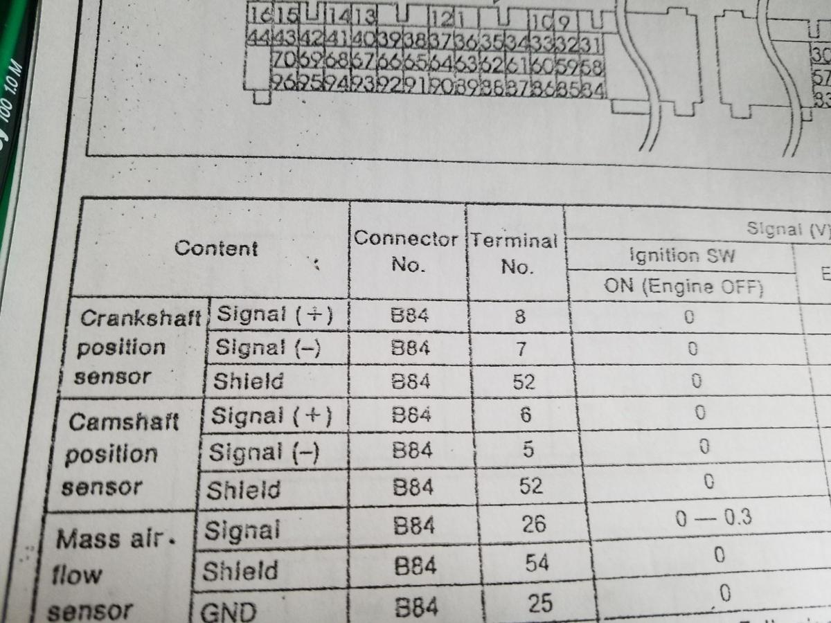

FIX MY BRAIN GENTLEMAN Which pins in my illustration are 5 6 7 8 respectively??? They 5 6 7 8 pins are for the Crank sensor and the Cam sensor as per the above PDF file provided to me for 95 only Subaru legacy... Why is my PCM not matching ANY of the information subaru has? I have 3 check engine codes. Code 1- Crank sensor failure, I got this error by cranking the engine over with the sensor UNPLUGGED in an experiment. Code 2- IAC failure, same as above, I cranked engine over several times with this unplugged and it set a code, because that's the computers job. Code 3- Injector 2 failure, because that is where I have the injector unplugged while cranking and using the noid light to check for signal. Once again, this is correct and proper for the system to tell me it's bad when it's unplugged. ALL 3 codes clear when I plug the sensors back in and clear codes and crank again with everything normal, and there are no error codes present after that. Just to let you know that the ECM is performing it's duties of monitoring for faults and reporting them, and it reports nothing when those components are put back into the system. OK, now back to the pin wiring as noted above. Who can gimme ideas why my harness is missing them? Is mine supposed to be numbered left to right top to bottom? Right to left top to bottom? Left to right bottom to top? Right to left bottom to top? And NO I do not have access to an oscilloscope.... My restoration shop is OLD as the hills, but all my SUN equipment went out long ago 8) As always, thanks for any thoughts
Conundrum as per this PDF diagram.... http://busaru.com/at...gacy Pinout.pdf Crank sensor pin 8 and 7 and cam sensor pins 6 and 5 as per the PDF, DO NOT exist on my ECM... They're blank... ANy thoughts? I will show you my pins in a photo in a second. Otherwise, I get all the correct voltage as per all yalls instructions to the important parts, yet I still have sporadic spark, but ZERO injector flash on a noid light until after key release as shown in a video I posted several day's ago. I am beginning to think this ECM is just done working, but need more info before tossing out a few hundred bucks at another no fix situation. The wiring in this car is UNMOLESTED, there's no freys or cut wires in the engine bay harnesses nor down near the ECM... Harness pic to follow
